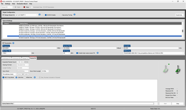

  • 1) For observing the activity on the SMA line, we currently have a setup with the spectrum analyzer. We connect the SMA line to a Siglent SSA3032 spectrum analyzer, with a 10 dB attenuator and short sweep time. When transmitting with RF_cmdPropTx we observe a expected signal at a regular interval, but do not observe so on the RF_cmdPropTxAdv. In addition, we also have another setup of launch pad with Rx application running to capture the packet, we have similar observation.
    2) According to your suggestion, I used SmartRF studio on our Windows machine with same protocol configuration as set on my Tx application with advanced command structure RF_cmdPropTxAdv. I do observe similar current consumption curve on the Tx end and also packets on the RF studio at correct interval as expected. I have attached the screenshot. We observe, a really high bit error rate which was unexpected. In couple of the run I do not receive any successful packet at all. I also tried lowing the packet length on the sysconfig to 64 bytes but with no prevail. What could be the issue, is it just the wireless environment or something I did in the radio configuration which makes such a high likelihood of bit error rate. And also, none of this properly explains non reliable signal observed on the spectrum analyzer.
    Thank you for your time. Looking forward to your comment.

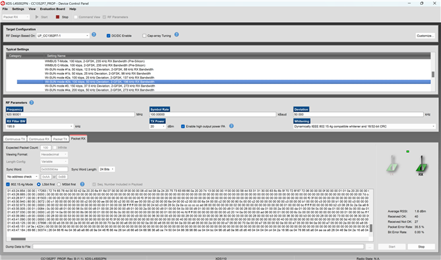

  • I redid the test today as well, however I could not receive any packets at all on the RFPacket Studio. It is still running the same firmware with the same exact configuration. Here is a screenshot for that,  .
    In the mean time, I was also looking at the current consumption.
    It has been like this, since I have started the test. There would be radio signals sometime without any issue, I would receive packets on my Rx devkit and the signal on the spectrum analyzer for some certain period and would stop again. There is no definite pattern I saw in any of this beside using the Adv structure or simple radio packet structure.
  • When you are using rfPacketTX example with any of the PHYs using the Advanced TX command (like the Wi-SUN PHYs) it is not enought to just replace the normal TX command in the code with the Advanced command and expect it to work.
    If you look at the documentation of the command in the TRM, you will see that while the normal TX command expect the packet length to only be written to the API, the advanced TX command expect the length to be written as part of the packet.
    Also, the Wi-SUN PHYs uses 802.15.4g mode, so the packets have a 2 bytes header, and the length is the 11 LSB of this header:
    Taking the rfPacketTX example, and changing for example the settings to Wi-SUN mode #2B, the following changes must be done in the rfPacketTX example to be able to receive the packets with another device using this modein SmartRF Studio
