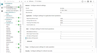

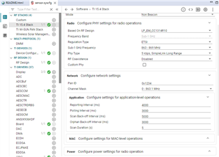

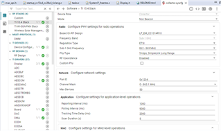

    1. Flash the sensor code to one board and collector code to another board. Attached the screenshots for your reference.

    **We have configured about the backoff exponent as follows,
    Hope to hear from you. Thanks for your continuous support.

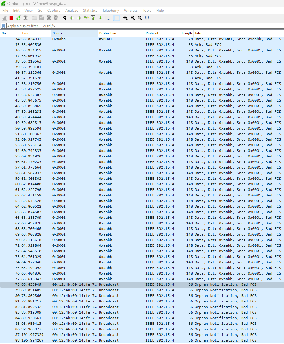

    I'll start by explaining the link controllers behavior. Once the device does not receive any response to it's data requests for the defined maximum of allowed data failures it will switch the state to orphaned. This state change will trigger an orphan scan using, as you linked, ApiMac_mlmeScanReq(&scanReq); with scanReq = orphan scan. The orphan callback will check if a response was received and change the interval of the orphan scan as defined in SysConfig with the backoff interval.
    I tried to reproduce what you are reporting and I observed the network traffic with a packet sniffer. As you can see in the picture below the first orphan scan is triggered after the maximum number of allowed data failures is reached and then performed according to the defined interval.
    I never got to a point where the initial orphan scan takes any delay after the maximum number of data failures is reached.

    - I can see that for this configuration the time from the last data request (58.2 s) to the fist orphan scan (65.8 s) is around 7 s due to the resending of the data request until the maximum number of allowed data failures is reached. Is this what you are referring to? You can change the number of allowed data failures by changing the define CONFIG_MAX_DATA_FAILURES and the maximum number of retries by changing the define CONFIG_MAX_RETRIES. By default both are configured to 5 and with the initial request this is 6x6=36 requests until the orphan scan starts (as you can see in the wireshark recording above).
