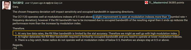

Additionally, TA12012's reply in the post indicates that the modulation index should always be 0.5 and above to ensure the proper operation of CC1101. and for low data rate, we should go with the high index.
inspired by his guidance, I have explored the different settings for my intended data rate 38.5k and made a comparison table as below:

    This will depend on your crystal accuracy. Both your options will not allow for a large crystal frequency offset:
    The first option should give 2.5 dB better sensitivity/range but important that the crystal offset never exceeds 10 kHz.
  • Hi, RGW
    Thanks for your prompt response.
    As a green hand, May I ask you how have you derived the crystal offset requirement 10kHz?
    Is it from the formula which Sverre presented in his commetnts as:
    BWchannel > BWsignal + 4* XTALppm* fRF ?
    4* XTALppm* fRF < BWchannel - BWsignal = 58 - 14.3 = 43.7kHz
    XTALppm*fRF < 43.7/4 = 10.9kHz ?
    The crystal offset requirement was entered as 10 kHz since this is the largest value that you could accept before exceeding the programmed Rx bandwidth with the PHY settings you choose.
    Correct with BWchannel > BWsignal + 4* XTALppm* fRF
