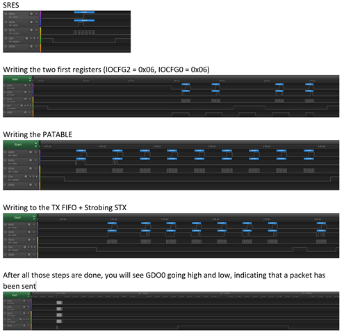

Hi, I have an issue with my code. Specifically, whenever I try to read data sent from the second CC1101 transceiver,
my code gets stuck waiting for the interrupt to indicate that the data has been received (while(GDO0_FLAG == 0);).
I’ve been trying to solve this problem for 2 weeks now. Below is the entire code along with the libraries used.

  • It is not possible for me to say why you are not receiving anything as I do not know anything abouth what HW you are using (custom HW or a CC1101 EM), what MCU you are writing your code for etc.
    How do you even know that the problem is on the receiver and not the transmitter? Do you knpw that you are sending a correct packet?
    The first thing you should do is to test TX and RX with settings from SmartRF Studio (use default settings without changes and get this to work before starting to change them).
    I selected the following:
    // Sync word qualifier mode = 30/32 sync word bits detected
    // CRC autoflush = false
    // Channel spacing = 199.951172
    // Data format = Normal mode
    // Data rate = 4.79794
    // RX filter BW = 101.562500
    // PA ramping = false
    // Preamble count = 4
    // Whitening = false
    // Address config = No address check
    // Carrier frequency = 867.999939
    // Device address = 0
    // TX power = 0
    // Manchester enable = false
    // CRC enable = true
    // Deviation = 25.390625
    // Packet length mode = Variable
    // Packet length = 255
    // Modulation format = GFSK
    // Base frequency = 867.999939
    // Modulated = true
    // Channel number = 0
    // PA table
    #define PA_TABLE {0x50,0x00,0x00,0x00,0x00,0x00,0x00,0x00,}
    static const registerSetting_t preferredSettings[]= {
        {CC1101_IOCFG2,     0x06},
        {CC1101_IOCFG0,     0x06},
        {CC1101_FIFOTHR,    0x47},
        {CC1101_PKTCTRL0,   0x05},
        {CC1101_FSCTRL1,    0x08},
        {CC1101_FREQ2,      0x21},
        {CC1101_FREQ1,      0x62},
        {CC1101_FREQ0,      0x76},
        {CC1101_MDMCFG4,    0xC7},
        {CC1101_MDMCFG3,    0x83},
        {CC1101_MDMCFG2,    0x93},
        {CC1101_DEVIATN,    0x40},
        {CC1101_MCSM0,      0x18},
        {CC1101_FOCCFG,     0x16},
        {CC1101_AGCCTRL2,   0x43},
        {CC1101_WORCTRL,    0xFB},
        {CC1101_FSCAL3,     0xE9},
        {CC1101_FSCAL2,     0x2A},
        {CC1101_FSCAL1,     0x00},
        {CC1101_FSCAL0,     0x1F},
        {CC1101_TEST2,      0x81},
        {CC1101_TEST1,      0x35},
        {CC1101_TEST0,      0x09},
    The only thing your code should do on the TX side, to for example send a packet with payload 0x05, 0x01, 0x02, 0x03, 0x04, 0x05 is the following:
    • Strobe SRES
    • Write the data above to the radio, including the PATABLE
    • Write the packet to the TX FIFO (5, 1, 2, 3, 4, 5)
    • Strobe STX
    Use a logic analyser to verify that all of the above is done correctly:
    On the RX side, you need to do the following:
    • Strobe SRES
    • Write the config registers to the radio (same as you used for TX)
    • Strobe SRX
    • Wait for GDO0 to get high and then low
    If your TX and RX uses the same settings and you have verified your SPI communication, and you still do not receive anything, this indicates that there are issues with your HW.
    This could be issues that are affecting the RF performance, if you have not followed out ref. Design for example, or there could simply be problems with reading the GDO0 pin from your MCU.
    Siri
