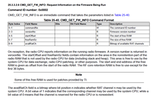

Is there any possibility that the RF core ROM code could have been changed between production runs?  How can one check the RF core ROM version?  Do you have any other ideas for things to check?
