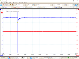

The CC1310 exits the sleep condition with a high-to-low transition lasting 530us. I have noticed that there are much faster transitions, on the order of a few us, which are unwanted effects that I have tried to eliminate with an RC low-pass filter, having a time constant of about 10us, but the problem has not been solved.
On the microcontroller side (downstream of the RC filter) I continue to see these unwanted signal transitions.
Could you help me understand where the problem lies?
I have seen that via SW you can set or not set the internal pullup on that DIO_2 pin, but either way I keep getting this problem.

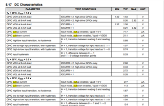

    I think you can infer the pull values looking at the current data:
    Arthur

    This is the picture:
    Unwanted interruption
    Thank you also for the pullup value, I thought that somewhere in the datasheet you could find the precise values in ohms.
    Regarding my problem, I think it is a disturbance on the power supply. I am trying to solve this problem by inserting an internal filter on pin DIO_2 via SW.
    I have seen that on the reference manual it is possible to set a hysteresis for the transition from HIGH to LOW via the HYST_EN register, but I cannot understand how I can extend the time of this hysteresis so that the CC1310 does not wake up for these unwanted interrupts lasting a few us.
    Would you happen to know how I can get around this problem? If for example there might be another, better way to make the microcontroller wake up only for interrupts greater than 10us.
