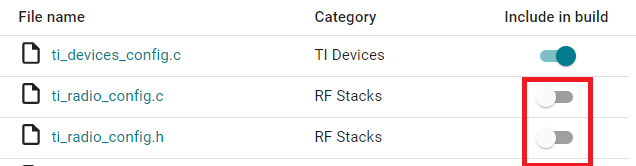

/* * ======== ti_radio_config.h ======== * Configured RadioConfig module definitions * * DO NOT EDIT - This file is generated for the CC1352P7RGZ * by the SysConfig tool. * * Radio Config module version : 1.18.0 * SmartRF Studio data version : 2.31.0 */ #ifndef _TI_RADIO_CONFIG_H_ #define _TI_RADIO_CONFIG_H_ #include <ti/devices/DeviceFamily.h> #include DeviceFamily_constructPath(driverlib/rf_mailbox.h) #include DeviceFamily_constructPath(driverlib/rf_common_cmd.h) #include DeviceFamily_constructPath(driverlib/rf_prop_cmd.h) #include <ti/drivers/rf/RF.h> /* SmartRF Studio version that the RF data is fetched from */ #define SMARTRF_STUDIO_VERSION "2.31.0" // ********************************************************************************* // RF Frontend configuration // ********************************************************************************* // RF design based on: LP_CC1352P7-1 #define LP_CC1352P7_1 // High-Power Amplifier supported #define SUPPORT_HIGH_PA // RF frontend configuration #define FRONTEND_SUB1G_DIFF_RF #define FRONTEND_SUB1G_EXT_BIAS #define FRONTEND_24G_DIFF_RF #define FRONTEND_24G_EXT_BIAS // Supported frequency bands #define SUPPORT_FREQBAND_868 #define SUPPORT_FREQBAND_2400 // TX power table size definitions #define TXPOWERTABLE_868_PA13_SIZE 20 // 868 MHz, 13 dBm #define TXPOWERTABLE_868_PA20_SIZE 8 // 868 MHz, 20 dBm #define TXPOWERTABLE_2400_PA5_SIZE 16 // 2400 MHz, 5 dBm // TX power tables extern RF_TxPowerTable_Entry txPowerTable_868_pa13[]; // 868 MHz, 13 dBm extern RF_TxPowerTable_Entry txPowerTable_868_pa20[]; // 868 MHz, 20 dBm extern RF_TxPowerTable_Entry txPowerTable_2400_pa5[]; // 2400 MHz, 5 dBm //********************************************************************************* // RF Setting: Custom (50 kbps, 25 kHz Deviation, 2-GFSK, 100 kHz RX Bandwidth) // // PHY: custom868 // Setting file: setting_tc706_custom.json //********************************************************************************* // PA table usage #define TX_POWER_TABLE_SIZE TXPOWERTABLE_868_PA13_SIZE #define txPowerTable txPowerTable_868_pa13 // TI-RTOS RF Mode object extern RF_Mode RF_prop; // RF Core API commands extern rfc_CMD_PROP_RADIO_DIV_SETUP_PA_t RF_cmdPropRadioDivSetup; extern rfc_CMD_FS_t RF_cmdFs; extern rfc_CMD_PROP_TX_t RF_cmdPropTx; extern rfc_CMD_PROP_RX_t RF_cmdPropRx; // RF Core API overrides extern uint32_t pOverrides[]; #endif // _TI_RADIO_CONFIG_H_
Here is the code to the generated source while in Custom RF @ 921 MHz with High PA on and output power set at +20dBm.
/* * ======== ti_radio_config.c ======== * Configured RadioConfig module definitions * * DO NOT EDIT - This file is generated for the CC1352P7RGZ * by the SysConfig tool. * * Radio Config module version : 1.18.0 * SmartRF Studio data version : 2.31.0 */ #include "ti_radio_config.h" #include DeviceFamily_constructPath(rf_patches/rf_patch_cpe_prop.h) // ********************************************************************************* // RF Frontend configuration // ********************************************************************************* // RF design based on: LP_CC1352P7-1 // TX Power tables // The RF_TxPowerTable_DEFAULT_PA_ENTRY and RF_TxPowerTable_HIGH_PA_ENTRY macros are defined in RF.h. // The following arguments are required: // RF_TxPowerTable_DEFAULT_PA_ENTRY(bias, gain, boost, coefficient) // RF_TxPowerTable_HIGH_PA_ENTRY(bias, ibboost, boost, coefficient, ldoTrim) // See the Technical Reference Manual for further details about the "txPower" Command field. // The PA settings require the CCFG_FORCE_VDDR_HH = 0 unless stated otherwise. // 868 MHz, 13 dBm RF_TxPowerTable_Entry txPowerTable_868_pa13[TXPOWERTABLE_868_PA13_SIZE] = { {-20, RF_TxPowerTable_DEFAULT_PA_ENTRY(0, 3, 0, 2) }, // 0x04C0 {-15, RF_TxPowerTable_DEFAULT_PA_ENTRY(1, 3, 0, 3) }, // 0x06C1 {-10, RF_TxPowerTable_DEFAULT_PA_ENTRY(2, 3, 0, 5) }, // 0x0AC2 {-5, RF_TxPowerTable_DEFAULT_PA_ENTRY(4, 3, 0, 5) }, // 0x0AC4 {0, RF_TxPowerTable_DEFAULT_PA_ENTRY(8, 3, 0, 8) }, // 0x10C8 {1, RF_TxPowerTable_DEFAULT_PA_ENTRY(9, 3, 0, 9) }, // 0x12C9 {2, RF_TxPowerTable_DEFAULT_PA_ENTRY(10, 3, 0, 9) }, // 0x12CA {3, RF_TxPowerTable_DEFAULT_PA_ENTRY(11, 3, 0, 10) }, // 0x14CB {4, RF_TxPowerTable_DEFAULT_PA_ENTRY(13, 3, 0, 11) }, // 0x16CD {5, RF_TxPowerTable_DEFAULT_PA_ENTRY(14, 3, 0, 14) }, // 0x1CCE {6, RF_TxPowerTable_DEFAULT_PA_ENTRY(17, 3, 0, 16) }, // 0x20D1 {7, RF_TxPowerTable_DEFAULT_PA_ENTRY(20, 3, 0, 19) }, // 0x26D4 {8, RF_TxPowerTable_DEFAULT_PA_ENTRY(24, 3, 0, 22) }, // 0x2CD8 {9, RF_TxPowerTable_DEFAULT_PA_ENTRY(28, 3, 0, 31) }, // 0x3EDC {10, RF_TxPowerTable_DEFAULT_PA_ENTRY(18, 2, 0, 31) }, // 0x3E92 {11, RF_TxPowerTable_DEFAULT_PA_ENTRY(26, 2, 0, 51) }, // 0x669A {12, RF_TxPowerTable_DEFAULT_PA_ENTRY(30, 1, 1, 68) }, // 0x895E // The original PA value (12.5 dBm) has been rounded to an integer value. {13, RF_TxPowerTable_DEFAULT_PA_ENTRY(36, 0, 0, 89) }, // 0xB224 // This setting requires CCFG_FORCE_VDDR_HH = 1. {14, RF_TxPowerTable_DEFAULT_PA_ENTRY(63, 0, 1, 0) }, // 0x013F RF_TxPowerTable_TERMINATION_ENTRY }; // 868 MHz, 20 dBm RF_TxPowerTable_Entry txPowerTable_868_pa20[TXPOWERTABLE_868_PA20_SIZE] = { {14, RF_TxPowerTable_HIGH_PA_ENTRY(13, 0, 0, 28, 0) }, // 0x00380D {15, RF_TxPowerTable_HIGH_PA_ENTRY(18, 0, 0, 36, 0) }, // 0x004812 {16, RF_TxPowerTable_HIGH_PA_ENTRY(24, 0, 0, 43, 0) }, // 0x005618 {17, RF_TxPowerTable_HIGH_PA_ENTRY(28, 0, 0, 51, 2) }, // 0x02661C {18, RF_TxPowerTable_HIGH_PA_ENTRY(34, 0, 0, 64, 4) }, // 0x048022 {19, RF_TxPowerTable_HIGH_PA_ENTRY(15, 3, 0, 36, 4) }, // 0x0448CF {20, RF_TxPowerTable_HIGH_PA_ENTRY(18, 3, 0, 71, 27) }, // 0x1B8ED2 RF_TxPowerTable_TERMINATION_ENTRY }; // 2400 MHz, 5 dBm RF_TxPowerTable_Entry txPowerTable_2400_pa5[TXPOWERTABLE_2400_PA5_SIZE] = { {-20, RF_TxPowerTable_DEFAULT_PA_ENTRY(8, 3, 0, 2) }, // 0x04C8 {-18, RF_TxPowerTable_DEFAULT_PA_ENTRY(10, 3, 0, 2) }, // 0x04CA {-15, RF_TxPowerTable_DEFAULT_PA_ENTRY(13, 3, 0, 3) }, // 0x06CD {-12, RF_TxPowerTable_DEFAULT_PA_ENTRY(16, 3, 0, 5) }, // 0x0AD0 {-10, RF_TxPowerTable_DEFAULT_PA_ENTRY(19, 3, 0, 5) }, // 0x0AD3 {-9, RF_TxPowerTable_DEFAULT_PA_ENTRY(20, 3, 0, 6) }, // 0x0CD4 {-6, RF_TxPowerTable_DEFAULT_PA_ENTRY(19, 2, 0, 11) }, // 0x1693 {-5, RF_TxPowerTable_DEFAULT_PA_ENTRY(21, 2, 0, 11) }, // 0x1695 {-3, RF_TxPowerTable_DEFAULT_PA_ENTRY(25, 2, 0, 12) }, // 0x1899 {0, RF_TxPowerTable_DEFAULT_PA_ENTRY(29, 1, 0, 22) }, // 0x2C5D {1, RF_TxPowerTable_DEFAULT_PA_ENTRY(33, 1, 0, 25) }, // 0x3261 {2, RF_TxPowerTable_DEFAULT_PA_ENTRY(38, 1, 0, 31) }, // 0x3E66 {3, RF_TxPowerTable_DEFAULT_PA_ENTRY(47, 1, 0, 36) }, // 0x486F {4, RF_TxPowerTable_DEFAULT_PA_ENTRY(32, 0, 0, 65) }, // 0x8220 {5, RF_TxPowerTable_DEFAULT_PA_ENTRY(46, 0, 0, 59) }, // 0x762E RF_TxPowerTable_TERMINATION_ENTRY }; //********************************************************************************* // RF Setting: Custom (50 kbps, 25 kHz Deviation, 2-GFSK, 100 kHz RX Bandwidth) // // PHY: custom868 // Setting file: setting_tc706_custom.json //********************************************************************************* // PARAMETER SUMMARY // RX Address Mode: No address check // Frequency (MHz): 921.0000 // Deviation (kHz): 75.0 // Packet Length Config: Variable // Max Packet Length: 255 // Preamble Count: 4 Bytes // Preamble Mode: Send 0 as the first preamble bit // RX Filter BW (kHz): 546.3 // Symbol Rate (kBaud): 300.000 // Sync Word: 0x930B51DE // Sync Word Length: 32 Bits // TX Power (dBm): 12.5 // Whitening: No whitening // TI-RTOS RF Mode Object RF_Mode RF_prop = { .rfMode = RF_MODE_AUTO, .cpePatchFxn = &rf_patch_cpe_prop, .mcePatchFxn = 0, .rfePatchFxn = 0 }; // Overrides for CMD_PROP_RADIO_DIV_SETUP_PA uint32_t pOverrides[] = { // override_tc706.json // Tx: Configure PA ramp time, PACTL2.RC=0x3 (in ADI0, set PACTL2[4:3]=0x3) ADI_2HALFREG_OVERRIDE(0,16,0x8,0x8,17,0x1,0x1), // Rx: Set AGC reference level to 0x1A (default: 0x2E) HW_REG_OVERRIDE(0x609C,0x001A), // Rx: Set RSSI offset to adjust reported RSSI by -1 dB (default: -2), trimmed for external bias and differential configuration (uint32_t)0x000188A3, // Rx: Set anti-aliasing filter bandwidth to 0xD (in ADI0, set IFAMPCTL3[7:4]=0xD) ADI_HALFREG_OVERRIDE(0,61,0xF,0xD), // override_prop_common_sub1g.json // TX: Set FSCA divider bias to 1 HW32_ARRAY_OVERRIDE(0x405C,0x0001), // TX: Set FSCA divider bias to 1 (uint32_t)0x08141131, // override_prop_common.json // DC/DC regulator: In Tx with 14 dBm PA setting, use DCDCCTL5[3:0]=0xF (DITHER_EN=1 and IPEAK=7). In Rx, use default settings. (uint32_t)0x00F788D3, (uint32_t)0xFFFFFFFF }; // CMD_PROP_RADIO_DIV_SETUP_PA // Proprietary Mode Radio Setup Command for All Frequency Bands rfc_CMD_PROP_RADIO_DIV_SETUP_PA_t RF_cmdPropRadioDivSetup = { .commandNo = 0x3807, .status = 0x0000, .pNextOp = 0, .startTime = 0x00000000, .startTrigger.triggerType = 0x0, .startTrigger.bEnaCmd = 0x0, .startTrigger.triggerNo = 0x0, .startTrigger.pastTrig = 0x0, .condition.rule = 0x1, .condition.nSkip = 0x0, .modulation.modType = 0x1, .modulation.deviation = 0x12C, .modulation.deviationStepSz = 0x0, .symbolRate.preScale = 0xF, .symbolRate.rateWord = 0x30000, .symbolRate.decimMode = 0x0, .rxBw = 0x5C, .preamConf.nPreamBytes = 0x4, .preamConf.preamMode = 0x0, .formatConf.nSwBits = 0x20, .formatConf.bBitReversal = 0x0, .formatConf.bMsbFirst = 0x1, .formatConf.fecMode = 0x0, .formatConf.whitenMode = 0x0, .config.frontEndMode = 0x0, .config.biasMode = 0x1, .config.analogCfgMode = 0x0, .config.bNoFsPowerUp = 0x0, .config.bSynthNarrowBand = 0x0, .txPower = 0xB224, .pRegOverride = pOverrides, .centerFreq = 0x0399, .intFreq = 0x8000, .loDivider = 0x05, .pRegOverrideTxStd = 0, .pRegOverrideTx20 = 0 }; // CMD_FS // Frequency Synthesizer Programming Command rfc_CMD_FS_t RF_cmdFs = { .commandNo = 0x0803, .status = 0x0000, .pNextOp = 0, .startTime = 0x00000000, .startTrigger.triggerType = 0x0, .startTrigger.bEnaCmd = 0x0, .startTrigger.triggerNo = 0x0, .startTrigger.pastTrig = 0x0, .condition.rule = 0x1, .condition.nSkip = 0x0, .frequency = 0x0399, .fractFreq = 0x0000, .synthConf.bTxMode = 0x0, .synthConf.refFreq = 0x0, .__dummy0 = 0x00, .__dummy1 = 0x00, .__dummy2 = 0x00, .__dummy3 = 0x0000 }; // CMD_PROP_TX // Proprietary Mode Transmit Command rfc_CMD_PROP_TX_t RF_cmdPropTx = { .commandNo = 0x3801, .status = 0x0000, .pNextOp = 0, .startTime = 0x00000000, .startTrigger.triggerType = 0x0, .startTrigger.bEnaCmd = 0x0, .startTrigger.triggerNo = 0x0, .startTrigger.pastTrig = 0x0, .condition.rule = 0x1, .condition.nSkip = 0x0, .pktConf.bFsOff = 0x0, .pktConf.bUseCrc = 0x1, .pktConf.bVarLen = 0x1, .pktLen = 0x14, .syncWord = 0x930B51DE, .pPkt = 0 }; // CMD_PROP_RX // Proprietary Mode Receive Command rfc_CMD_PROP_RX_t RF_cmdPropRx = { .commandNo = 0x3802, .status = 0x0000, .pNextOp = 0, .startTime = 0x00000000, .startTrigger.triggerType = 0x0, .startTrigger.bEnaCmd = 0x0, .startTrigger.triggerNo = 0x0, .startTrigger.pastTrig = 0x0, .condition.rule = 0x1, .condition.nSkip = 0x0, .pktConf.bFsOff = 0x0, .pktConf.bRepeatOk = 0x0, .pktConf.bRepeatNok = 0x0, .pktConf.bUseCrc = 0x1, .pktConf.bVarLen = 0x1, .pktConf.bChkAddress = 0x0, .pktConf.endType = 0x0, .pktConf.filterOp = 0x0, .rxConf.bAutoFlushIgnored = 0x0, .rxConf.bAutoFlushCrcErr = 0x0, .rxConf.bIncludeHdr = 0x1, .rxConf.bIncludeCrc = 0x0, .rxConf.bAppendRssi = 0x0, .rxConf.bAppendTimestamp = 0x0, .rxConf.bAppendStatus = 0x1, .syncWord = 0x930B51DE, .maxPktLen = 0xFF, .address0 = 0xAA, .address1 = 0xBB, .endTrigger.triggerType = 0x1, .endTrigger.bEnaCmd = 0x0, .endTrigger.triggerNo = 0x0, .endTrigger.pastTrig = 0x0, .endTime = 0x00000000, .pQueue = 0, .pOutput = 0 };
I also found that there is a separate sysconfig for High PA which only appears if you set any value between +14 and +19 dBm but not on +20dBm. Regardless, does not work in any of the configuration.
