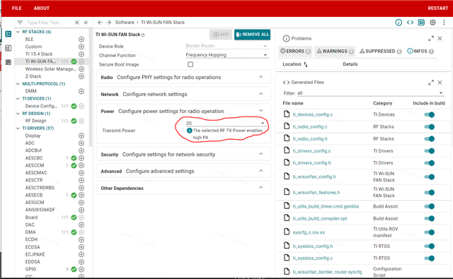

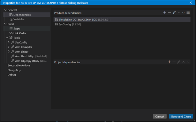

I am working on a project which uses CC1354P10 as a Wi-SUN BR. When I test the ns_br example(simplelink_cc13xx_cc26xx_sdk_7_41_00_17\examples\rtos\LP_EM_CC1354P10_1\ti_wisunfan\ns_br\tirtos7), and change the tx power to 20dBm, the program runs not right as expected.
After I control the module with pyspinel by inputing the "ifconfig up", the program always  runs to the default_pa (RF_TxPowerTable_DefaultPA)  snipppet,not the  HighPA(RF_TxPowerTable_HighPA) snippet in rfDriverCallbackAntennaSwitching(RF_Handle client, RF_GlobalEvent events, void *arg) function (ti_drivers_config.c). The pics below show the problem I encountered,while a CC1352P7 module works normally.
How do I resolve this problem? Does this work right?  Any suggestions would be greatly appreciated.

  • Hi Jie,
    thank you for the detailed description.
    Could you please share with me how you configured the 20 dBm output power in the project?
    Could you then please also share the generated ti_radio_config.c and explain me how you measure the output power?

  • Hi Theo,
    I configure the tx power value  using the Sysconfig sofware by clicking ti_wisunfan_border_router.syscfg file as shown below figure.

    I measure the  the output power with the pyspinel tool by using its command "rssi" . After a network with three nodes is formed, I can test the rssi value with the command. The power value of a CC1352P7 module with the same distance and the same  antenna is larger about 7dBm or more than the CC1354P10 module. I debug the code and find the above situation that CC1354P10 code runs to the DefaultPA section after the "ifconfig up" command is excuted.
    Thanks for your reply!
    Jie

  • Hi Jie,
    I apologize for the delay.
    Please check that you use the latest version of the SDK: https://www.ti.com/tool/download/SIMPLELINK-LOWPOWER-F2-SDK/8.30.01.01
    I tested with this and I can see that the radio configuration is composed correctly.
    Please let me know if that solves your issue. If not please share the ti_radio_config.c that you get using this SDK.
    Kind regards,
    Theo
  • Hi Theo,
    I  tested the SDK 8_30_01_01 a week ago, it did not work either. After I reveived the email,I retested the sdk with the example ns_br_src again, it had the same results as SDK7_41_00_17 except that the Radio Config module version and SmartRF Studio data version number had been changed in the ti_radio_config.c file. What's the difference between the 2 projects you generated and I generated?  I use IAR for compiling. Thanks!
    Jie

    How to correct these values you mentioned to right ones that work normally? (BR_CC1354 can support more nodes than BR_1352.) Thank you!
    Jie

  • Hi Jie,
    when you right click in CCS on the project name and navigate to Properties -> General -> Products -> SimpleLink CC13xx CC26xx SDK you can select the installed SDK version that you want to use.
    Can you please confirm that 8.30.1.1 is selected and saved before you build the project?
    Kind regards,
    Theo
  • Hi Theo,
    I checked the sdk version, it is indeed 8.30.1.01. Why the
    ti_radio_config.c CCS generated is different with yours? Thanks!

    Jie
