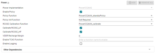

We designed a new IoT device and are measuring its power consumption to optimize energy efficiency, particularly in sleep mode.
In our measurements, we used three identical sensors with the same hardware and firmware. However, each device exhibits unique and varying power consumption in sleep mode:
  • Device_1: 2.26 µA
  • Device_2: 132 µA
  • Device_3: 94.9 µA
Based on our calculations, we expected the sleep mode power consumption to be between 12-15 µA.
To investigate whether the issue is related to our firmware, we examined the efficiency of GPIO usage in relation to our hardware design. To test this, we flashed our IoT device with a basic empty example project for the CC1312R, configured the GPIO pins using SysConfig, and repeated the measurements. However, we still observed the same power consumption values as you seen from the below picutre.
As shown in the image below, there are also maximum peak measurements. I suspect the issue might be related to our O₂ sensor (Luminox); however, we are not supplying power to it via GPIOs.
 https://ibb.co/h140Krm2
https://ibb.co/7JGXp7v8

also here is my sysconfig as text form:

const CCFG = scripting.addModule("/ti/devices/CCFG", {}, false);
CCFG.ccfgTemplate.$name = "ti_devices_CCFG_CCFGCC26XXTemplate0";

    Unfortunately I am not able to see the images since the server is blocked by TI intranet.
    Did you test this on a custom board or on a LaunchPad?
    I would not recommend using Power_idleFunc() and other power drivers to control the power level of the device. Instead I would set the power policy (PowerCC26XX_standbyPolicy) in SysConfig and let the scheduler handle the power states. If you look at the empty project sysconfig this is how it's handled there.
    Cheers,
    Marie H
  • Hi Marie,
    Thank you for your response. I tested this on our custom boards, but even though the boards are identical, the results were different. I tested two boards with the same firmware, yet their power consumption was not the same. Below is the power consumption data and comparison graphics with empty project  mentioned earlier:
    https://ibb.co/XfBqKLbV
    I also want to mention that my power sysconfig configuration is the same as yours. I set the power policy (PowerCC26XX_standbyPolicy) as shown below and also applied your recommendations but result was same.
    https://ibb.co/V0q3FT1x
