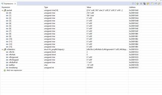

Problem:
1. When transmitting my packet with RF_cmdPropTxAdv and listen with RF_cmdPropRxAdv  I only receive the header information on the other side: `0F D6 BE` and nothing that comes after.
What I expect to see in the RFQueue is `0F D6 BE AB CD EF 01 23 45 AA BB CC DD EE FF`
When I play with the header configuration settings, like changing length and address positioning, then the packet gets filtered out for not matching the address.
I'm certain that the TX device is transmitting more than just 3 bytes based on my energy trace profile.
2. I expect my RF_cmdPropRxAdv to continue receiving packets after the first one is received given the configuration, but it only receives one and stops giving callbacks.

  • Hi Marciano,
    Have you tested your CMD_PROP_RX_ADV/CMD_PROP_TX_ADV configuration in SmartRF Studio 7 prior to the code implementation? What do you observe there?
    The TX side seems to be correct as the screenshot shows, but it would be interesting to see what you receive..
    Arthur
  • Hi Arthur,
    I attempted to test the CMD_PROP_RX_ADV/CMD_PROP_TX_ADV configuration in SmartRF Studio 7 version 2.32.0 as you suggested.
    However, I'm encountering a persistent issue where SmartRF Studio 7 repeatedly prompts for installation of the "Radio Test library" for SimpleLink Wireless MCUs, even after successful installation and system reboot. The SmartRF Test Environment fails to launch properly on my Windows 10 PC. Attaching the screenshot for your reference. What could be the problem?, Note that I've also included the Radio Test Library folder path to the system enviroment just in case.
    And Could you please provide guidance on the specific event pattern I'm consistently observing:
    First callback: RF_EventRxOk | RF_EventCmdDone (0x810000)
    Second callback: RF_EventLastCmdDone | RF_EventCmdError (0x400002)
    The first packet header is received and parsed correctly (length=12, address=0xBED6), but the CMD_PROP_RX_ADV terminates after a single packet despite bRepeatOk=1 and bRepeatNok=1 configuration.
    Is this the expected behavior for advanced RX commands, or does it indicate a configuration issue?
    Sharan

  • First of all, it is not possible to use SmartRF Studio to test this (changing the complete packet format from default will also require that the firmware itself changes)
    Below is some test code that transmit the packet you have given, and there is also code to show how this packet can be correctly received.
    I have changed the first byte in the packet from 0x0F to 0x0E, as the length byte should tell how many bytes come AFTER the length (should not include itself)
    I used the rfPacketRX and rfPacketTX examples as a starting point, and changed the necessary parameters (data rate, deviation, sync word, preamble and whitening in sysconfig), and the rest of the parameters was modified in the code itself:

  • Hi Siri,
    Thank you for the valuable inputs and test code. We were able to successfully recreate the setup as suggested by you using the rfPacketRX and rfPacketTX examples as the starting point. RX callback is now triggered every 500ms based on TX timer (continuous reception working!)
    However, I still see the payload data showing as all zeros in the received packet.
    I've attached both TX and RX projects for your reference. Note that I've added UART debug (Display_printf) for debugging - hope that shouldn't be a problem.

    Sharan
  • I am not able to reproduce your problem.
    I ran your RX and TX code, and everything worked as expected.
    I have attached the complete code examples for your convenience (the example is based on the rfPacketRX/TX examples from the latest SDK, and I am using CCS 12.8.0)
    2211.demo.zip
    Siri
    I compared the syscfg files, looks like you're using the latest SDK - simplelink_cc13xx_cc26xx_sdk@8.30.01.01?
    That's the main big difference, we've been trying the older SDK 7_41.
    Do you suggest to try with the new SDK?
    Sharan
  • Hi Siri,
    I verified with SDK 8.30, and it works!
    Now, I’d like to move forward with our original issue i.e. getting the chained command to work.
    Do you have any pointers or example references that could help?
    Sharan
