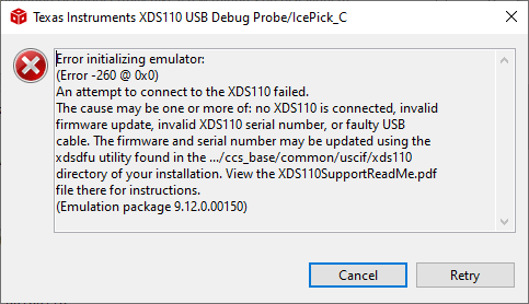

  • Hi Theo,
    as suggested, I completely removed Uniflash and reinstalled it from scratch, installation completed with no error, but once launched Uniflash, a new issue arised: the Launchpad (let me call it A) is no longer detected. If I change the Launchpad (call this second one as B), it is normally available as usual. What have I to do?
    Please note:
    - to this test, I attached only one Launchpad at a time and hence prior to connect Launchpad B, Launchpad A is removed from the USB (and the typical sound from Windows is heared either when unplugging and plugging the Launchpads)
    - the green led on the Launchpad A is on
    - if I try to use the Launchpad A with the CCS debugger, the emulator does no longer respond and the following diagnostic appears:
    - so, it seems the Launchpad A is no longer functional but probably it is possibile to recover it with a suitable tool: can you tell me how can I do that?
    - instead, if I try to use the Launchpad B, no issue
    Obviously I need both Launchpads working...
    Please help me
    Sincerely Luigi
  • Hi Luigi,
    thank you for the update.
    The issue seems to be that the XDS110 firmware is in a bad state.
    Please try to resolve the issue as indicated by the error message.
    Connect the LaunchPad with the error and start the xdsdfu utility in powershell from your CCS installation directory/ccs_base/common/uscif/xds110/xdsdfu.exe
    A User's Guide for the utility can be found in the same directory as pdf.
    Please follow the instructions to update the XDS110 firmware and verify that the update was successfull.
    Afterwards, everything should work fine.
    Kind regards,
    Theo

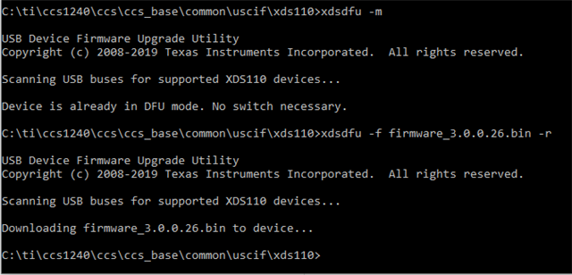

  • Hi Theo,
    I read the documentation and provide an attempt to "Recover a Bricked XDS110 without JTAG", strictly following what is said. Then I downloaded the firmware available for the XDS110 (maybe it is an old version, but this is not a concern to me since Uniflash should update it automatically). Here following the screenshot of what I did:
    The Launchpad then is recognized by Windows, its green led lits, but Uniflash still does not recognize it: what have I to do now? I don' t think the Launchpad is failed at all.
    Sincerely
    Luigi
  • Hi Luigi,
    could you verify with xdsdfu -m that the new version of the firmware was installed on the XDS110?
    Did you disconnect and reconnect the LaunchPad from the PC before starting Uniflash again?
    If yes please send me a screenshot of how the XDS110 is listed in the windows device manager -> COM ports.
    Kind regards,
    Theo
  • Hi Theo,
    now all is working again as expected after this sequence:
    - disinstalled uniflash
    - completely removed the installation folder where at least two empty files still survived after disinstallation (why? it should not happen...)
    - used xdsdfu to restart the Launchpad from scratch, shorting the TDO pin to gnd as mentioned in the documentation about "Recover a Bricked XDS110 without JTAG"
    - reinstalled uniflash leaving connected the Lauchpad to the USB port (that is powered)
    - used xdsdfu to download the firmware version available in the just installed uniflash with -r option which means the xds is rebooted aftermath
    At this point the Launchpad comes visible to both CCS and uniflash (with Windows sounding behavior)
    Then, running any function on Uniflash, it is required to update the xds firmware and I did it (it proceeds autonomously)
    So, finally, the Launchpad is functional as it once was.
    Problem finally solved, but I really don' t know what was the cause of this issue. Anyway, now I know how to do in the case this might happen again.
    Many thanks,
    Sincerely,
    Luigi
