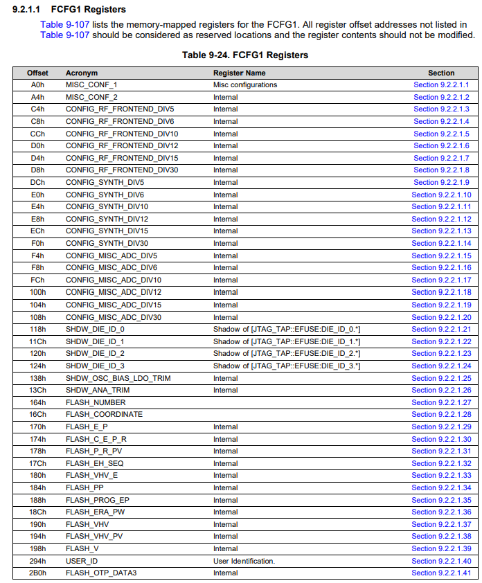

Hi Johny,
what you are referring to is the die id in the factory configuration fcfg of the device.
Please have a look at chapter 9.2.1.1. of the TRM: https://www.ti.com/lit/ug/swcu117i/swcu117i.pdf for all fcfg values.
The die id and mac address are unique.

Thanks! The doc says "DIE_ID_0 register in eFuse row number 3." ID's 1, 2, and 3 are on rows 4, 5, and 6 respectively.
So what's the difference between DIE_ID_0, DIE_ID_1, DIE_ID_2, and DIE_ID_3?
Doc says "Default value depends on eFuse value."
What does "Default value" mean if DIE_ID is different for every device?
Where's MAC address in your linked doc?
