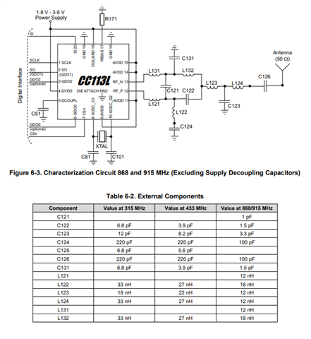

I'm using the CC113L with an own prototipe as a Keelog receiver for 868.35 MHz band. Following the design note DN022, a  post in the forum about receiver for keelog and the Applications, Implementation, and Layout section of the datasheet, I find myself with a receiver working for a range of less than 10 meters.
I have tried to increase the range modifying the registers but nothing seems to work, increasing the sensibility only makes the signal disappear in noise. I have tried playing with the AGCCTRL registers, the Data Rate
 and BW, but the range doesn't get any better.  What configuration/change should i make in orfer to improve the range?

    • What HW are you using?
    • If you test the range using a default PHY setting (e.g. GFSK) and SmartRF Studio 7, does the range issue persist or is it specific to these PHY settings?
    Zack
  • Please take a look at www.ti.com/.../swra603a.pdf
  • Hi Zack,
    I'm using a custom HW, the radio desing nonetheless is as per recomended in the datasheet with the same component values. The antenna I'm using is a semi-rigid cable.
    The same HW for GFSK works fine with a range of 50 meter.
    Denis
  • The sensitivity measures are poor (wireless and wired). I'm using the recommended HW and the configuration of the SmartRF Studio 7. Since the same HW works for GFSK i guess that there is something with the configurations.
  • Hi Denis,
    Apologies for the delay on this. I have unlocked the thread and aim to reply early next week. I need feedback from the design team for how to progress this.
    From what you say (good performance with GFSK), it does sound like a configuration issue rather than a HW issue, but are you able to confirm this with conducted measurements as outlined in SWRA603? That makes it easier to quantify the performance in a way that is repeatable.
    Zack
  • Hi Zack,
    Glad to know about you. The measures conducted are following the SWRA603 using a signal generator sending preamble data. The signal is visible at -32 dBm. Since the HW is the one recommended in the datasheet I also think that it is related to the configuration, but I don't find the register that make it work.
