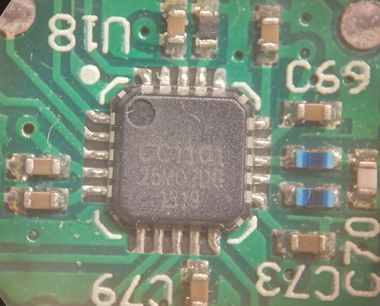

******Anyway- this device the CC1101 I have not seen in this package before :
  (or see link if doesnt embed the image )
I was asked to troubleshoot  a customer's production.
The TI chip is a CC1101  sub GHz radio chip. am familiar with.
what I could see was  that the CC1101 chips of the boards in question did not look like the CC1101s I am used to seeing
Instead of classic  QFN, these devices looks like LFCSP (ADI style) .
looks normal  chip : CC1101 T12 BF SO3D G4  (looks like usual TI VQFN mold)
suspect chip : CC1101   25M02DG 1319 (ADI CSP-like  mold)
the 'suspect parts' work, but.. they're a little different in  RF behaviour.
did you make  these in the CSP ? I think these have been built in the past 6 years.

  • Hi Glen,
    If you do not have a direct FAE contact then using the E2E forums as the first step is recommended.
    This could potentially be a CC1101 device that used the old RTK packaging, see the following thread:  CC1101: RTK package - Re-marked CC1100?
    However, these were phased out over 12 years ago. These could be genuine devices but, if so, they are very old - this unit could be from 2013 or 2012.
    Without knowing more about the issues you are seeing it is difficult to comment further, but the RTK package was used at one point (before the current RGP package).
    Zack
  • Hi Zack
    thank you very much for the information
    I consider this question now resolved !
    FWIW, same components, the older devices have ~ 2.5dB greater power output.
    I have told the customer if they are having problems with 2.5dB, their systems has design issues.
    With the compromised antennas, I would expect +/- 3dB spread across production, and they need to fix the antenna on the other end. Nevertheless they've got a whole batch that 'work' and newer ones that dont work. (down to the last dB). so, they've got to fix the link budget and antennas
