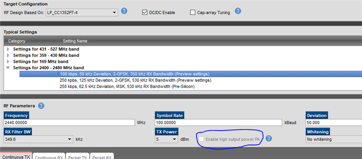

I'm trying to generate a continuous 2.4GHz signal with the PA mode enabled in smart RF, but this option is disabled and I'm found a way to enabled it yet, could you help me to find the solution?
Hi Raul,
I would suggest you use the BLE TX settings, although thoses are not validated: CC1352P7: how to set up 20dBm PA at 2.4Ghz band. - Sub-1 GHz forum - Sub-1 GHz - TI E2E support forums
