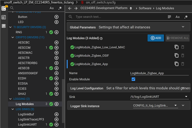

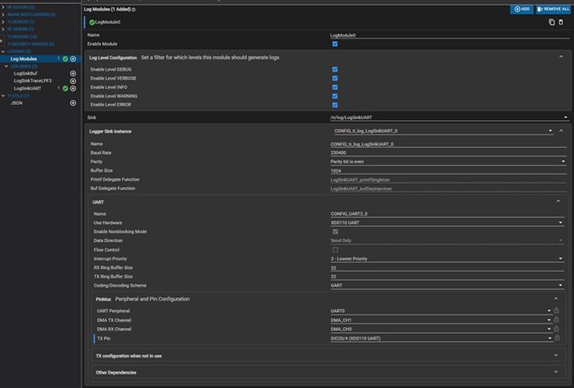

customer tried to enable the logging function regarding the SDK User's Guide:
https://dev.ti.com/tirex4-desktop/explore/content/simplelink_lowpower_f3_sdk_9_11_00_18/docs/zigbee/html/debugging/inc_logging_feature.html?highlight=log

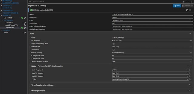

He activated the Log Module in sysconfig and choose UART as Sink.

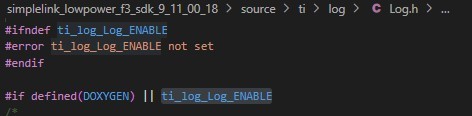

der  ti_log_Log_ENABLE flag is defined:
He can find the correct files ti_log_config.s/.d/.h in the directory Debug/syscfg.

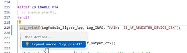

But the Log_printf is not defined and runs into nowhere. At debug it shows that is not activated and it is stepped over. Compiler optimisation is -O0. The IDE function Expand Makro will also vanish it.
How can the logging over UART be activated?
Regards, Holger

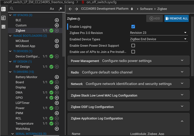

    It's not clear what example this is based off.  There there are clear instructions in a SimpleLink Academy Lab as well: https://dev.ti.com/tirex/explore/node?node=A__ARAJIfGVesVIAWpXnZI8Iw__SIMPLELINK-ACADEMY-CC23XX__gsUPh5j__LATEST
    If Zigbee like suggested with the UG hyperlink then "Enable Logging" should be selected in the SysConfig -> Zigbee module, where further "Zigbee...Log Configuration" windows are then shown.  They would then continue to utilize the TI Log Tool as described in the documentation.
    Ryan
  • Hi Ryan,
    do we have an example with log function?
    Regards, Holger
  • Yes the Zigbee examples are prepared with logging enabled once the SysConfig button is selected and the project is rebuilt.
    Ryan

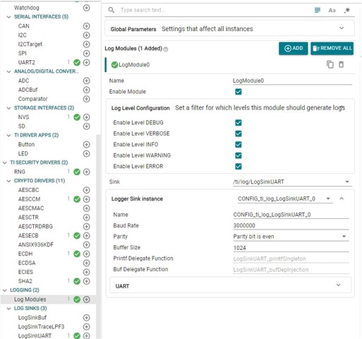

  • Hi Ryan,
    he did step by step as in the description:
    https://dev.ti.com/tirex/explore/content/simplelink_academy_for_cc23xx_8_40_01_00/_build_simplelink_academy_for_cc23xx_8_40_01_00/source/debug/cc23xx_debugging_logging.html#bonus-task-add-logging-to-an-rf-driver-example
    The Log_printf marco is not compiled und is skipped when stepping debuging.
    Also stepping into the macro showed that the contain is empty.
    Regards, Holger

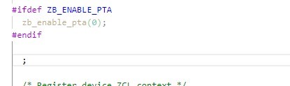

  • That's the correct SLA but not yet correctly applied to a Zigbee project
    Notice the LogModule_Zigbee_App name.
    Ryan

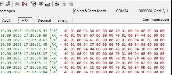

  • Hi Ryan,
    By changing the name to LogModule_Zigbee_app, he could actually see that characters are being output to the UART. He first read this with a terminal.
    Can it be that logging is not done in ASCII format, but is interpreted by the tilogger in a different way?
    Unfortunately, the attempt to commission the tilogger also failed.

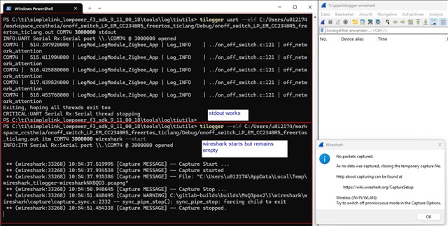

  • Hi Ryan,
    he has installed in both ways, in .venv and globally. The error messages are the same in both cases. In the appendix he has attached installation logs for global and venv installation.
    In the following it can be seen that tilogger --help leads to the "TypeError: Parameter.make_metavar() missing 1 required positional argument: 'Ctx'".
    A call without --help generally seems to work with the error message that arguments are missing.
    The log to the stdout seems to work (section ## try log to stdout in "tilogger_install_log(glob).text)
    Login to Wireshark (section ## try log to wireshark in tilogger_install_log(glob).txt) fails with error message "wireshark: Invalid -o flag "UAT:user_DLTs:"User 0 (DLT=1)","tilogger","0",","0","""": User_DLTs:147: Dissector not found"
    Is there still a Wireshark plugin needed?
    Can we have a call with the customer?
    Regards, Holger

    PS C:\ti\simplelink_lowpower_f3_sdk_9_11_00_18\tools\log\tiutils> tilogger --help
     Usage: tilogger [OPTIONS] COMMAND1 [ARGS]... [COMMAND2 [ARGS]...]...
     Parse LogSinkITM and LogSinkUART log output, or use replay file functionality to store/replay log streams.
     This tool may be used to instantiate a serial port parser for the ITM and UART Log Sinks. The tool receives logs generated with the Log.h API and reconstructs and displays the log output
     by using the encoded metadata in the toolchain-generated ELF output.
     A simple invocation (provided Wireshark is installed) is
     tilogger --elf path/to/elf.out itm COM3 12000000 wireshark --start
    ┌──────────────────────────────────────────────────────────────────────────── Traceback (most recent call last) ────────────────────────────────────────────────────────────────────────────┐
    │ C:\Python310\Scripts\tilogger-script.py:33 in <module>                                                                                                                                    │
    │   30                                                                                          ┌─────────────────────── locals ───────────────────────┐                                    │
    │   31 if __name__ == '__main__':                                                               │  re = <module 're' from 'C:\\Python310\\lib\\re.py'> │                                    │
    │   32 │   sys.argv[0] = re.sub(r'(-script\.pyw?|\.exe)?$', '', sys.argv[0])                    │ sys = <module 'sys' (built-in)>                      │                                    │
    │ > 33 │   sys.exit(load_entry_point('tilogger==0.2.0', 'console_scripts', 'tilogger')())       └──────────────────────────────────────────────────────┘                                    │
    │   34                                                                                                                                                                                      │
    │ C:\Python310\lib\site-packages\tilogger\logger.py:237 in main                                                                                                                             │
    │   234 │   │   subtyper(logger_cli)                                                                                                                                                        │
    │   235 │   │   # logger_cli.add_typer(subtyper, name=entry_point.name)                                                                                                                     │
    │   236 │                                                                                                                                                                                   │
    │ > 237 │   logger_cli()                                                                                                                                                                    │
    │   238                                                                                                                                                                                     │
    │   239                                                                                                                                                                                     │
    │   240 if __name__ == "__main__":                                                                                                                                                          │
    │ ┌───────────────────────────────────────── locals ─────────────────────────────────────────┐                                                                                              │
    │ │ entry_point = EntryPoint.parse('wireshark = tilogger_wireshark.main:output_factory_cli') │                                                                                              │
    │ C:\Python310\lib\site-packages\typer\main.py:340 in __call__                                                                                                                              │
    │ C:\Python310\lib\site-packages\typer\main.py:323 in __call__                                                                                                                              │
    │ C:\Python310\lib\site-packages\click\core.py:1462 in __call__                                                                                                                             │
    │ C:\Python310\lib\site-packages\typer\core.py:743 in main                                                                                                                                  │
    │ C:\Python310\lib\site-packages\typer\core.py:197 in _main                                                                                                                                 │
    │ C:\Python310\lib\site-packages\click\core.py:1206 in make_context                                                                                                                         │
    │ C:\Python310\lib\site-packages\click\core.py:1806 in parse_args                                                                                                                           │
    │ C:\Python310\lib\site-packages\click\core.py:1217 in parse_args                                                                                                                           │
    │ C:\Python310\lib\site-packages\click\core.py:2516 in handle_parse_result                                                                                                                  │
    │ C:\Python310\lib\site-packages\click\core.py:2411 in process_value                                                                                                                        │
    │ C:\Python310\lib\site-packages\click\decorators.py:539 in show_help                                                                                                                       │
    │ C:\Python310\lib\site-packages\click\core.py:750 in get_help                                                                                                                              │
    │ C:\Python310\lib\site-packages\click\core.py:1084 in get_help                                                                                                                             │
    │ C:\Python310\lib\site-packages\typer\core.py:757 in format_help                                                                                                                           │
    │ C:\Python310\lib\site-packages\typer\rich_utils.py:610 in rich_format_help                                                                                                                │
    │ C:\Python310\lib\site-packages\typer\rich_utils.py:369 in _print_options_panel                                                                                                            │
    TypeError: Parameter.make_metavar() missing 1 required positional argument: 'ctx'
    Try 'tilogger --help' for help.
    ┌─ Error ───────────────────────────────────────────────────────────────────────────────────────────────────────────────────────────────────────────────────────────────────────────────────┐
    │ Missing command.                                                                                                                                                                          │

  • A call without --help generally seems to work with the error message that arguments are missing.
    This would appear to be progress.  I have also observed similar issues with the "--help" option but ultimately it sounds like the log functionality is working.
    Have they followed instructions for Configuring Wireshark, which includes dissector installation?
    Please have them exhaust the TI log README instructions and test with multiple computers if possible.  Note that I am on PTO from 9/24 through 9/26.
    Ryan
  • Hi Ryan,
    the chapter with the .lua file he actually overlooked. Now Wireshark starts from the tilogger. However, the capture window remains empty. However, the module sends data as seen with the stdout method.
    Since the help call does not work for him, would it be possible to send the help contents in a text file?
    Regards, Holger
  • You can refer to the TI Log document for the contents of the help command.
    Ryan
  • you mean under here:
    TI Log Tool User's Guide
