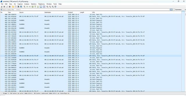

When running this setup I observer two scenarios.
1. collector and sensors are all working fine i.e no packet losss and no disconnection.

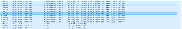

2. Sensors are continuously disconnected (orphaned) and rejoining. Also many data lost
sniffer log:
In both scenarios HW setup is same and the code is also the same; nothing modified.
In the disconnection log I could see that the ACK is missing and due to the missing ACK, the sensors are orphaned.
Upon analysing the TI15.4 guide, in NBCN- direct data transfer sequence,
they didn't mention more about this ACK and how it is generated.
So My questions are,
a) What actually this ack? is collector is giving this ack?
b) The collector moves to Tx and sends ACK if any sensor packet is received.
Because when analyzing my attached images, in working condition the time difference between the next sensor packets is 500 to 600 ms. which means in between that collector sends the ACK and the network is fine.
In my disconnection images the sensor packets are triggered within 150 ms. Is it really a problem. Since It is a multi sensor network -  each sensor can trigger packet at any time.
c) So in a multi-sensor network, is there any limitation or condition mentioned that sensor reporting packets should be triggered with more than 150ms?

  • Hi Muniyappan,
    a) Yes, these are ACK. Every message is ack'ed by the collector. Since there are no beacons, this is the only way the sensor knows it is still in the network. After a certain number of missed ACKs, the sensor will start sending the orphan notifications.
    b) and c) I'm not aware of the limitation, I'm going to do some more research and come back to you. What SDK version are you using? Are you running the fully embedded collector project or the coprocessor with a linux host?
    Daniel

  • Hi Muniyappan,
    From your capture it seems the packet is 105 Bytes (or is this the payload, without the MAC and PHY header? ). In any case, if the packet is 105 bytes, the packet transmission is about 105*8/5kbps = 168ms. Meaning that in a 150ms window, the tail of the first packet is overlapping with the head of the second packet. Clearly this is not enough, you would need at least 168ms gap, probably even a bit more so that the ACK can be transmitted.
    If 105 Bytes is just the payload, the packet is about 120 bytes, giving you a transmission time of 192ms.

    From your response
    actually I am using the multi sensor in the network, so It is impossible to maintain 160ms delay across the sensor transmissions in the network (since one sensor don't know when the other sensor transmitted the packet).
    So is there any way to overcome this issue?

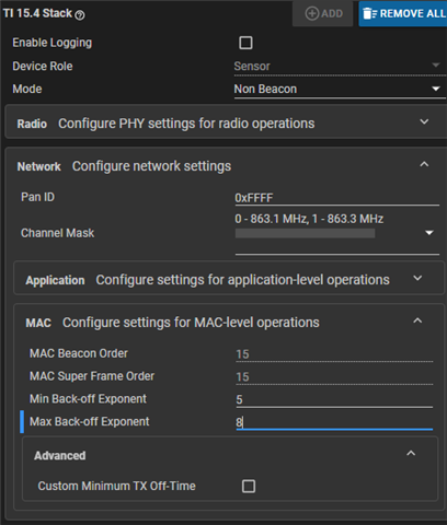

  • HI Muniyappan,
    The non-beacon mode uses unslotted CSMA algorithm, when a device wants to transmit it waits a random period, if the channel is idle the device transmits, otherwise it backoffs again for a random period of time. For Long Range Mode, we should increase the backoff times, the following values are recommended:
    CONFIG_MIN_BE = 5 (default 3)
    CONFIG_MAX_BE = 8 (default 5)
    You can change this at Sensor's Sysconfig > TI 15.4-Stack > Network > MAC.
    Could you try this and check if it improves collision avoidance?
    You could also increase the reporting interval if it fits within your requirements.

  • Hi Daniel,
    We tested the network with updated backoff interval.
    5 sensors - 1 Collector and an additional sniffer. NBCN mode - 5kbps PHY. Reporting interval as 10s and polling interval as 20 sec.
    Setup ran for 12 hours. all the sensors are placed within 20 feet from the collector.
    Following are the observations:
    Sensor Reporting Packet Loss on the Collector Side Sensor Orphan and rejoin count
    S1 1 2
    S2 4 9
    S3 14 11
    S4 1 0
    S5 0 1
    So I think the network is more stable compared to previous scenarios.
