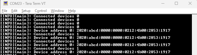

    I wrote my own get_connected_devices based on NcpBase::HandlePropertyGet<SPINEL_PROP_CONNECTED_DEVICES>(void) which I call every 1 second from application.c of ns_br.

    Once a node joins, the address is printed
    Hopefully, this helps your question.
