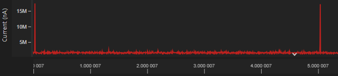

I am working with the CC1312R1, both on a LaunchPad and on a custom board, and I am comparing current consumption measurements using EnergyTrace in CCS and an oscilloscope (with a small shunt resistor in series with the supply). I am using the rfPacketTx example with POWER_MEASUREMENT defined.
The problem is that the results are not consistent:

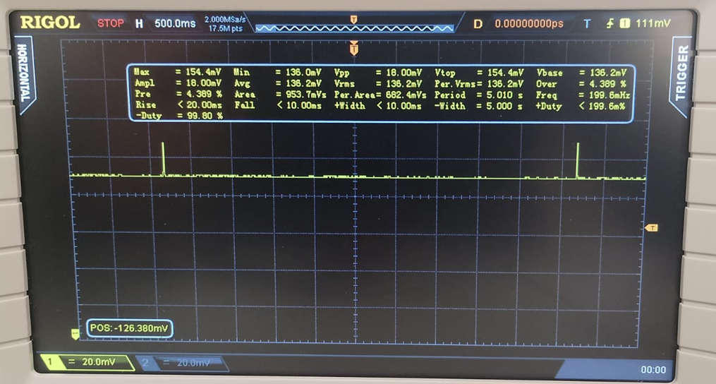

  • On the LaunchPad, EnergyTrace reports a decent low consumption, while the oscilloscope shows much higher values.

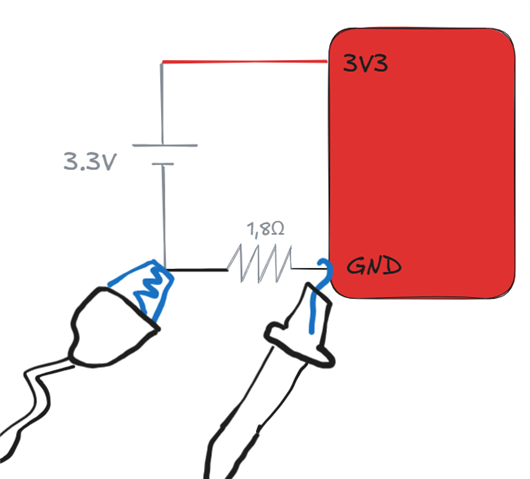

    As I said, I am measuring the voltage difference in a 1.8 ohm shunt resistor in series with the supply. I remove all 11 jumpers in the center of the launchpad and selected Extern power. The measuring circuit is something like this: I got the same results with the resistor in the positive side.
  • On the custom board, the oscilloscope readings were lower than on the LaunchPad but still not as smaller as in the datasheet:  Max Current  = 17.7 mA, STANDBY Current = 444.4 uA
           For this measurement I am only using the RF module, passivating all other circuits.
           In this case, the inconsistency with EnergyTrace was in the opposite way:
            with the oscilloscope I got a lower value.

  • Power supply ground is isolated (verified by continuity measurement).
  • Tested different shunt resistors (1.8 Ω, 22 Ω). With 22 Ω the launchpad did not power up.
  • Oscilloscope probe set to 10x.
  • Also tried differential measurement, but results remain inconsistent.
