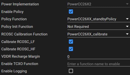

I looked in driver examples but not found one wihch cover:
Puting device into sleep (constantly) and wakeup by clock or gpio for 120 sec.
I am using just RF (continous RX) + Uart, I closed RF and call UART2_rxDisabled() and then call Power_sleep(), and current drop from 10mA to 80uA, unfortunatelly I cant wakeup from this state because current rise only to 750uA.
Can you advice example will explain me it better?
Marek
Hi Marek,
In stead of calling Power_sleep(), please try setting up a clock or timer and implement a callback event. Or even easier, just use sleep(120) (the same is used in the drivers/empty project).
As long as your power policy allows it, the device will go to sleep aka standby when nothing is happening.

I just try it with no luck
Got empty project, Start Debuging, next Trace/Enable Energy Trace, empty chart appear. and F5.
I noticed messages, gathering data, Data Capture Finished, in just one second.
According to instructions, I cant find in ccs 20.3.0.14
Marek
