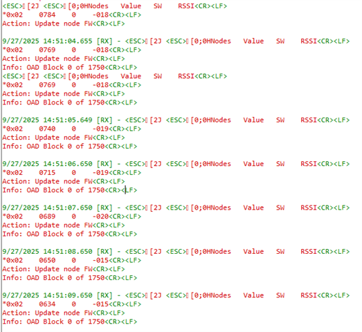

  • Hi Vinod,
    1) There is support for On-chip after release SDK 1.5 (SimpleLinkTm CC13x0 SDK 1.50.00.08 Release Notes),that's why you will find an example project rfWsnNodeIntFlashOadClient, however bear in mind the flash limitation. I suggest you use the latest one  4.20.02.07.
    2) Have you tried flashing the BIM hex file + the rfWsnNodeIntFlashOadClient bin generated as explained in the README file?
    3) Are you using the right BIM file? That is bim_onchip project for the on-chip solution?
    Daniel

    ->Another attempt:
    *Flashed bim_intflash_cc13x0lp.hex with UniFlash
    *Flashed rfWsnNodeIntFlashOadClient_CC1310_LAUNCHXL_tirtos_ccs.hex using CCS
    In this case, when I initiate OAD from the server, it keeps showing repeatedly:
    "Info: OAD Block 0 of 1750"

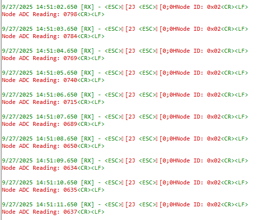

    But on the client side, no operation happens.I have attached screenshots:
    Pic-1: Server side log
    Pic-2: On-Chip Client side
