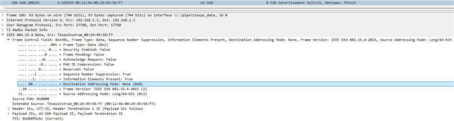

    And you can see the value being transmitted over the air with a sniffer for the PAN Advertisement Solicit.
    1 and 2) In all cases, the address length is 8 bytes, the unused bytes are filled with zeros. Take a look at the address decoder in api_mac.c of the TI15.4-Stack Linux Gateway SDK.
