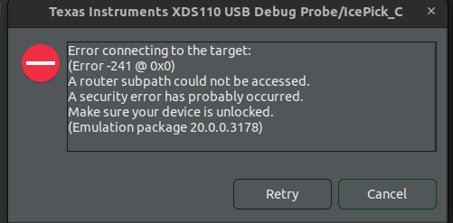

I am working with CC1311P3 LaunchPad. After flashing a new firmware with the SysConfig shown below, I am no longer able to connect with CCS or UniFlash.
Bootloader: disabled
Bootloader Backdoor: disabled
Debug Access (CPU DAP, TEST TAP, PBIST, AON): all unchecked
Error from CCS/UniFlash:
IcePick_C: Error connecting to the target: (Error -241 @ 0x0)
A router subpath could not be accessed. A security error has probably occurred.
Is there any recovery method in this situation?
For development, what is the recommended safe CCFG config (to avoid bricking)?
