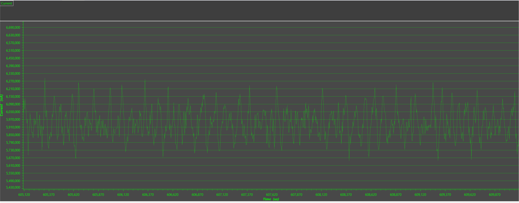

  • Can you check that your device is able to advertise before this happens?
    Using EnergyTrace, there's no obvious sign that the device is transmitting (no clear increase in current consumption).
    I am using the LightBlue v2.7.0 app on a Google Pixel 6A, which is able to see advertising packets from other nearby BLE apps.
    Are you able to try and reproduce the issue using your own hardware and software?
  • Hi Andrew,
    This just looks like noise. (It might help to unplug and replug the usb cable after opening EnergyTrace.) In any case you should see it quite clearly when the radio is active.
    Did you make any code changes to the example?
    Cheers,
    Marie H

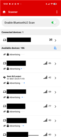

    Edit:
    An example that does work is the project `dmm_154collector_remote_display_app_LP_EM_CC1354P10_1_tirtos7_ticlang` in version 7.41.00.17 of the SDK. The screenshot shown below is TI's SimpleLink Connect version 2.1.0. The phone and LaunchPad on the same desk, so I think we can be confident that the RF path can work, and I'd like to verify that the DMM examples do work.
