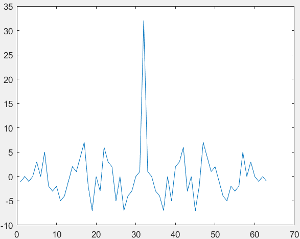

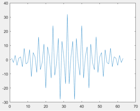

  1. Sync Word Requirements: Are there specific autocorrelation or pattern requirements for 4-GFSK sync words? Why would 0x5A5A5A5A fail completely while 0xF498E83A works initially?
    The sync word 0x5A5A5A5A has poor correlation, therefore, it's not surprising that you don't have reception.
    the sync word 0xF498E83A shows much better correlation.
    Is this the same sync word you are using in you 2-FSK implementation?

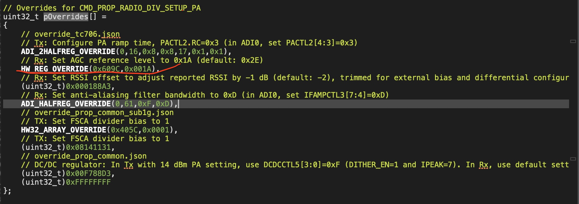

  • Hi Diego,
    Thanks for your reply.
    After tweaking a few parameters, I found that adjusting the gain resolved the reception issue. I changed the AGC reference level from 0x1A to 0x2E. The following couple of lines were added after RF_open to enable 4-GFSK and adjust the AGC.
    RF_cmdPropRadioDivSetup.formatConf.fecMode = 0x09;
    extern uint32_t pOverrides[];
    pOverrides[1] = ((uint32_t)0x609C << 16) | 0x002E;
    //SysCfg Settings
    //symbolRate = 500.000; // 500 kbaud
    //deviation = 125.0; // 125 kHz
    //rxFilterBw = "1092.5"; // 1092.5 kHz
    //Modulation index: h = 125 kHz / (500 kHz / 2) = 0.5
    Auto-generated code in ti_radio_config.c
    Now my question is: how can I calculate the optimal AGC reference level for 4-GFSK on the CC1352P7 with custom PHY settings for both 868 MHz and 915 MHz?
    Sharan
