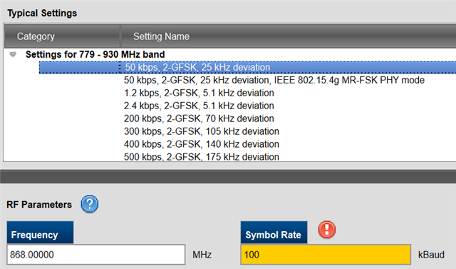

Tutorial says to "type in 100 in the Symbol Rate text box". That causes error.
  • Hi Johny,
    Did you also update the Deviation and RX filter Bandwidth?
    Cheers,
    Marie H

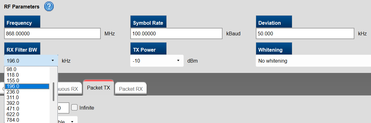

  • Ok, entering Deviation 50 as per the tute fixed the error on Symbol Rate.
    Issue 1: Tute says "choose 195.9 kHz from the RX Filter BW drop down list".
    dev.ti.com/.../prop_01_basic.html
    I don't see 195.9, but i do see 196.

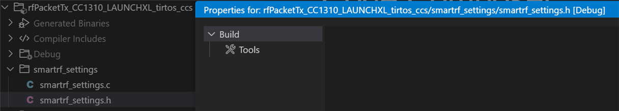

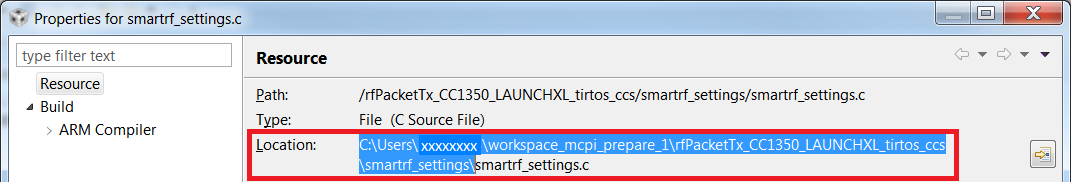

    Issue 2: The tute says "In CCS, find the folder location of [smartrf_settings.c and smartrf_settings.h], by right-clicking one of them in the project explorer, then selecting Properties. In the properties window, look for the Location entry."
    I don't see that. Here's what i see:

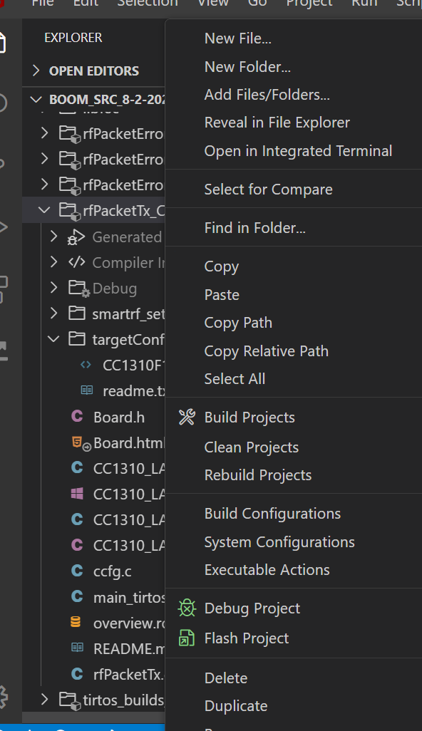

    Issue 3: Tute says to "Build and Run". I don't have "Build and Run", but i do have "Flash Project". Is that what it means? "Flash Project" seems to work.

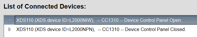

    Issue 4: Tute says to "Start up a SmartRF Studio instance and connect to the "RX" LaunchPad." Unclear: When i start SmartRF Studio, it seems to automatically connect to the devices which are plugged in. I can't find a "Connect" button or menu option. Is that an obsolete instruction? Do they mean, "Double-click the RX device in the List of Connected Devices to open it in connected mode"?

    Regarding issue 2 and 3: The tutorial was written for an older version of CCS. If you use CCS 12 it will match the descriptions in the Simplelink Academy lab. (You can still use CCS 20, it just looks a bit different.)
    4: "Connect" here means physically, connect the launchpad to your laptop with the USB cable.

    I think you might be incorrect about number 4. The hardware is already physically connected to the USB. That is done at the beginning of the tutorial. The tutorial assumes it's still connected. The instructions don't say connect the device to the computer comment the directions say to connect Smart RF to the device. Smart RF is software. Please submit a ticket for that.
