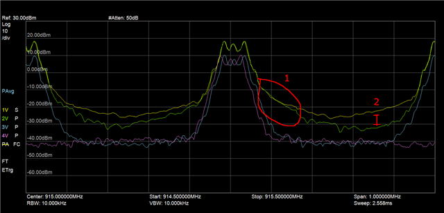

  • Hi David,
    could you share spectrum plots showing what you describe?
    1. Spectrum plot of 20 dBm path with force VDDR enabled.
    2. Spectrum plot of 20 dBm path with force VDDR disabled.
    3. Spectrum plot of 14 dBm path.
  • I am attaching the traces.  The extra noise is more pronounced when changing channels, and since this is a frequency hopping radio, I've loaded a test firmware which switches between channels every 20ms.  SmartRF Studio sweep function puts a lot of dead time between transmissions, so it doesn't show the noise well.
    Yellow = LP-CC1311P3 High PA w/ Force VDDR on
    Green = LP-CC1311P3 High PA w/ Force VDDR off
    Blue = LP-CC1311P3 Low Power w/ Force VDDR on
    Purple = Reference radio (our own CC1200 based design; I can't easily load a test software on it right now, but trust me that it doesn't have the extra energy/noise between channels that the LP-CC1311P3 High PA has).
    We noticed extra energy in the marked area 1 when changing channels.  This energy is less pronounced when doing a static channel test.  Also, note the gap at the marked area 2 when comparing the Force VDDR option.

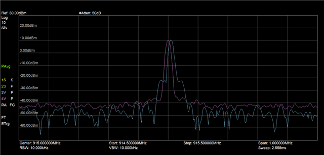

    Additionally for reference, you can also see extra noise on LP-CC1311P3 when comparing it to our reference CC1200 module.  You can see the extra wide "hips" about halfway down the carrier in the image below.
    Blue = LPCC1311-P3 CW mode (from SmartRF Studio)
    Purple = CC1200 based radio in CW mode.
