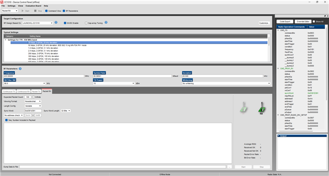

I have a question regarding the project I am working on.
I have two boards that need to communicate with each other. One of them uses a CC1101 and the other one uses a CC1310.
When the CC1101 is configured with Configuration 1 and the CC1310 is set as shown in Screenshot 1, the communication works.
When I export Screenshot 1 to code, it generates a file similar to the attached smartrf_settings1.txt.

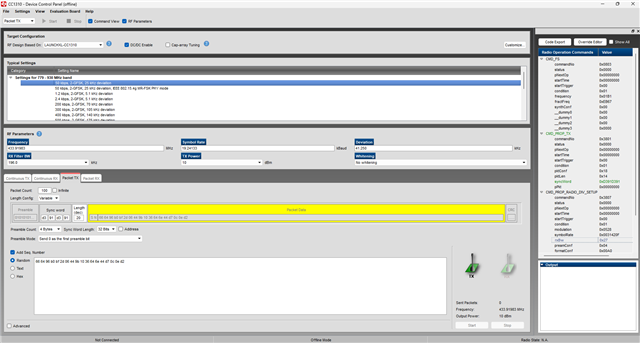

However, I would like to use Configuration 2 on the CC1101 side. For this, I configured the CC1310 as shown in Screenshot 2 and generated smartrf_settings2.txt. But in this case, communication does not work.
Could you please help me with this?
How should I configure the CC1310 to make it compatible with Configuration 2?

Screenshot1:
// Generated by SmartRF Studio version 2.32.0 (build#409)
// The applied template is compatible with CC13x0 SDK version 2.10.xx.xx or newer.
// Device: CC1310 Rev. B (2.1).
// Parameter summary
// RX Address0: 0xAA
// RX Address1: 0xBB
// RX Address Mode: No address check
// Frequency: 433.00000 MHz
// Data Format: Serial mode disable
// Deviation: 20.500 kHz
// Packet Length Config: Variable
// Max Packet Length: 255
// Packet Length: 20
// Packet Data: 255
// RX Filter BW: 98.0 kHz
// Symbol Rate: 38.38501 kBaud
// Sync Word Length: 32 Bits
// TX Power: 15 dBm (requires define CCFG_FORCE_VDDR_HH = 1 in ccfg.c, see CC13xx/CC26xx Technical Reference Manual)
// Whitening: No whitening
//murat deneme

    .rxBw = 0x24,
    .preamConf.nPreamBytes = 0x4,
    .preamConf.preamMode = 0x0,
    .formatConf.nSwBits = 0x20,
    .formatConf.bBitReversal = 0x0,
    .formatConf.bMsbFirst = 0x1,
    .formatConf.fecMode = 0x0,
    .formatConf.whitenMode = 0x0,
    .config.frontEndMode = 0x0,
    .config.biasMode = 0x1,
    .config.analogCfgMode = 0x0,
    .config.bNoFsPowerUp = 0x0,
    .txPower = 0x913F,
    .pRegOverride = pOverrides,
    .centerFreq = 0x01B1,
    .intFreq = 0x8000,
    .loDivider = 0x0A
// CMD_FS
// Frequency Synthesizer Programming Command
rfc_CMD_FS_t RF_cmdFs =
    .commandNo = 0x0803,
    .status = 0x0000,
    .pNextOp = 0, // INSERT APPLICABLE POINTER: (uint8_t*)&xxx
    .startTime = 0x00000000,
    .startTrigger.triggerType = 0x0,
    .startTrigger.bEnaCmd = 0x0,
    .startTrigger.triggerNo = 0x0,
    .startTrigger.pastTrig = 0x0,
    .condition.rule = 0x1,
    .condition.nSkip = 0x0,
    .frequency = 0x01B1,
    .fractFreq = 0x0000,
    .synthConf.bTxMode = 0x0,
    .synthConf.refFreq = 0x0,
    .__dummy0 = 0x00,
    .__dummy1 = 0x00,
    .__dummy2 = 0x00,
    .__dummy3 = 0x0000
// CMD_PROP_RX
// Proprietary Mode Receive Command
rfc_CMD_PROP_RX_t RF_cmdPropRx =
    .commandNo = 0x3802,
    .status = 0x0000,
    .pktConf.bFsOff = 0x0,
    .pktConf.bRepeatOk = 0x0,
    .pktConf.bRepeatNok = 0x0,
    .pktConf.bUseCrc = 0x1,
    .pktConf.bVarLen = 0x1,
    .pktConf.bChkAddress = 0x0,
    .pktConf.endType = 0x0,
    .pktConf.filterOp = 0x0,
    .rxConf.bAutoFlushIgnored = 0x0,
    .rxConf.bAutoFlushCrcErr = 0x0,
    .rxConf.bIncludeHdr = 0x1,
    .rxConf.bIncludeCrc = 0x0,
    .rxConf.bAppendRssi = 0x0,
    .rxConf.bAppendTimestamp = 0x0,
    .rxConf.bAppendStatus = 0x1,
    .syncWord = 0xD391D391,
    .maxPktLen = 0xFF,
    .address0 = 0xAA,
    .address1 = 0xBB,
    .endTrigger.triggerType = 0x1,
    .endTrigger.bEnaCmd = 0x0,
    .endTrigger.triggerNo = 0x0,
    .endTrigger.pastTrig = 0x0,
    .endTime = 0x00000000,
    .pQueue = 0, // INSERT APPLICABLE POINTER: (dataQueue_t*)&xxx
    .pOutput = 0 // INSERT APPLICABLE POINTER: (uint8_t*)&xxx
// CMD_PROP_TX
// Proprietary Mode Transmit Command
rfc_CMD_PROP_TX_t RF_cmdPropTx =
    .commandNo = 0x3801,
    .status = 0x0000,
    .pktLen = 0x14,
    .pPkt = 0 // INSERT APPLICABLE POINTER: (uint8_t*)&xxx
Screenshot2:
// RX Address0: 0x00
// RX Address1: 0x00
// Frequency: 433.91983 MHz
// Deviation: 41.250 kHz
// Packet Data: 255
// RX Filter BW: 196.0 kHz
// Symbol Rate: 19.24133 kBaud
// TX Power: 10 dBm
#include "smartrf_settings.h"
#include DeviceFamily_constructPath(rf_patches/rf_patch_cpe_genfsk.h)
#include DeviceFamily_constructPath(rf_patches/rf_patch_rfe_genfsk.h)
// TI-RTOS RF Mode Object
RF_Mode RF_prop =
    .rfMode = RF_MODE_PROPRIETARY_SUB_1,
    .cpePatchFxn = &rf_patch_cpe_genfsk,
    .mcePatchFxn = 0,
    .rfePatchFxn = &rf_patch_rfe_genfsk
// Overrides for CMD_PROP_RADIO_DIV_SETUP
uint32_t pOverrides[] =
    // override_use_patch_prop_genfsk.xml
    // PHY: Use MCE ROM bank 4, RFE RAM patch
    MCE_RFE_OVERRIDE(0,4,0,1,0,0),
    // override_synth_prop_863_930_div5.xml
    // Synth: Set recommended RTRIM to 7
    HW_REG_OVERRIDE(0x4038,0x0037),
    // Synth: Set Fref to 4 MHz
    (uint32_t)0x000684A3,
    // Synth: Configure fine calibration setting
    HW_REG_OVERRIDE(0x4020,0x7F00),
    HW_REG_OVERRIDE(0x4064,0x0040),
    (uint32_t)0xB1070503,
    (uint32_t)0x05330523,
    // Synth: Set loop bandwidth after lock to 20 kHz
    (uint32_t)0x0A480583,
    (uint32_t)0x7AB80603,
    // Synth: Configure VCO LDO (in ADI1, set VCOLDOCFG=0x9F to use voltage input reference)
    ADI_REG_OVERRIDE(1,4,0x9F),
    // Synth: Configure synth LDO (in ADI1, set SLDOCTL0.COMP_CAP=1)
    ADI_HALFREG_OVERRIDE(1,7,0x4,0x4),
    // Synth: Use 24 MHz XOSC as synth clock, enable extra PLL filtering
    (uint32_t)0x02010403,
    // Synth: Configure extra PLL filtering
    (uint32_t)0x00108463,
    // Synth: Increase synth programming timeout (0x04B0 RAT ticks = 300 us)
    (uint32_t)0x04B00243,
    // override_phy_rx_aaf_bw_0xd.xml
    // Rx: Set anti-aliasing filter bandwidth to 0xD (in ADI0, set IFAMPCTL3[7:4]=0xD)
    ADI_HALFREG_OVERRIDE(0,61,0xF,0xD),
    // override_phy_gfsk_rx.xml
    // Rx: Set LNA bias current trim offset to 3
    (uint32_t)0x00038883,
    // Rx: Freeze RSSI on sync found event
    HW_REG_OVERRIDE(0x6084,0x35F1),
    // override_phy_gfsk_pa_ramp_agc_reflevel_0x1a.xml
    // Tx: Configure PA ramping setting (0x41). Rx: Set AGC reference level to 0x1A.
    HW_REG_OVERRIDE(0x6088,0x411A),
    HW_REG_OVERRIDE(0x608C,0x8213),
    // override_phy_rx_rssi_offset_5db.xml
    // Rx: Set RSSI offset to adjust reported RSSI by +5 dB (default: 0), trimmed for external bias and differential configuration
    (uint32_t)0x00FB88A3,
    (uint32_t)0xFFFFFFFF
// CMD_PROP_RADIO_DIV_SETUP
// Proprietary Mode Radio Setup Command for All Frequency Bands
rfc_CMD_PROP_RADIO_DIV_SETUP_t RF_cmdPropRadioDivSetup =
    .commandNo = 0x3807,
    .status = 0x0000,
    .condition.rule = 0x0,
    .modulation.modType = 0x0,
    .modulation.deviation = 0xA5,
    .symbolRate.preScale = 0xF,
    .symbolRate.rateWord = 0x3142,
    .symbolRate.decimMode = 0x0,
    .rxBw = 0x27,
    .formatConf.fecMode = 0xA,
    .txPower = 0x46CB,
    .intFreq = 0x8000,
    .loDivider = 0x0A
// CMD_FS
    .status = 0x0000,
    .fractFreq = 0xEB7A,
    .__dummy0 = 0x00,
    .__dummy1 = 0x00,
    .__dummy2 = 0x00,
    .__dummy3 = 0x0000
// CMD_PROP_RX
    .status = 0x0000,
    .maxPktLen = 0xFF,
    .address0 = 0x00,
    .address1 = 0x00,
// CMD_PROP_TX
    .status = 0x0000,
    .pktLen = 0x14,
  • Hi Cagri,
    Can you tell me what the difference is between Configuration 1 and 2?
    Cheers,
    Marie H
  • Hello Marie, thank you for your reply.
    Since Configuration 2 is currently being used in the field, I don’t want to change it. Therefore, I need to make the CC1310 compatible with Configuration 2.
    I have summarized the differences between Configuration 1 and Configuration 2 in a table.
      register define register addres Configuration 1 value Configuration 2 value
    Frequency Control CCxxx0_FREQ0 0x0F 0x62 0x71
    CCxxx0_FREQ1 0x0E 0xA7 0xB0
    CCxxx0_FREQ2 0x0D 0x10 0x10
    Modem Configuration CCxxx0_MDMCFG0 0x14 0xF8 0xF8
    CCxxx0_MDMCFG1 0x13 0x22 0x22
    CCxxx0_MDMCFG2 0x12 0x13 0x0E
    CCxxx0_MDMCFG3 0x11 0x83 0x84
    CCxxx0_MDMCFG4 0x10 0xCA 0x89
    Modem Deviation CCxxx0_DEVIATN 0x15 0x35 0x45
    Frequency Offset Compensation CCxxx0_FOCCFG 0x19 0x16 0x76
    Bit Synchronization CCxxx0_BSCFG 0x1A 0x6C 0x6D
    AGC Control CCxxx0_AGCCTRL0 0x1D 0x91 0x91
    CCxxx0_AGCCTRL1 0x1C 0x40 0x40
    CCxxx0_AGCCTRL2 0x1B 0x03 0xC7
    Front End RX Configuration CCxxx0_FREND1 0x21 0x56 0xB6
