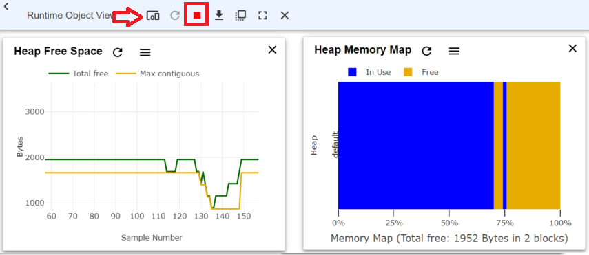

  • Hi, thank you for the reply. We are using CC1310 that doesn't have much ram. Is there a function to check status of a heap when in debug? How much more ram is needed if we increase the number by 1 e.g. from default 2 to 3 (is this like 100, 200, 300,... bytes?) so that we can check how much and where we can decrease to make sure we don't overflow.

  • Hi Reno,
    You can use the Runtime Object View (ROV) on debugger mode. To get the HeapMem to show on ROV make the following changes to the app.cfg
    var HEAPMGR_CONFIG = 0x82; // instead of 0x80
    Comment out these two lines
    var ROM = xdc.useModule('ti.sysbios.rom.ROM');
    ROM.romName = ROM.CC1350;
    Rebuild the project, and start a debug session.
    Open the ROV view from Tools, add the plot by clicking on the marked button and enable the continuous refresh. You should see something like this:
    Increasing the MAC_CFG_TX_DATA_MAX definition by 1 won't increase the usage by itself, it will happen once data is queued into the buffer.
    In this example I used BTN-1 to trigger Collector_sendToggleLedRequest and enqueue a message, I pressed the button a few times and you can see it on the plot as the data is enqueued and sent. Each call used 264 bytes, increasing SMSGS_TOGGLE_LED_REQUEST_MSG_LEN also increases the buffer occupation as expected, however it is much larger than just the payload, probably due to the stack headers and some other overhead.
    So I don't know exactly how big it is, but also take into account your payload. My suggestion is to give it a try as I did and figure out your limit. Probably 7-10 is too much for the CC1310, as the idle free heap was 1952 bytes. Maybe start with the default value of 2 and test your application.
    The difference between MAC_CFG_TX_DATA_MAX and MAC_CFG_TX_MAX is that the former defines the maximum amount of data frame, and the latter the maximum amount of tx any frame (command, data).
    Daniel
