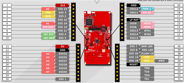

How to restore cc1310 to factory firmware and settings?
Can i find the factory firmware in the Resource Explorer?
On the board, i see RST and RESET pins. Is that related?
The example that comes with the boards when we ship them are the rfPacketErrorRate example.
The example is part of the SDK and can be found here:
I will have someone from the HW team comment on the two resets on the LP.
