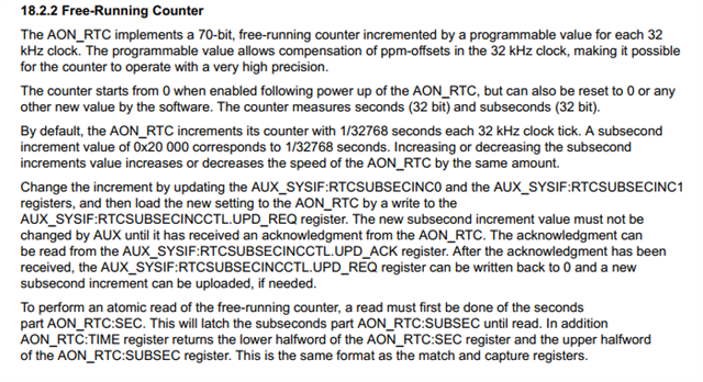

Hi Team,
            In CC1314 70bit RTC is there. I want to use that for my produce (I assume it can count upto years - 70bit running on 32K crystal). So I am trying to init , set , reset, and read the RTC.
First of all I could not find any example on the SimpleLink SDK. I read some of the e2e threads and found this file, aon_rtc.h
< https://software-dl.ti.com/simplelink/esd/simplelink_cc13x0_sdk/4.10.00.10/exports/docs/driverlib_cc13xx_cc26xx/cc13x0/driverlib/group__aonrtc__api.html>
Which has some APIs and it is matching with the reference manual.
However, I wonder that it doesn't have an RTC set API, It has only the reset API that will set the reset bit on the control register.
So my question is that,
 can we set the RTC with our custom value during run time in CC1314R10?

Also From manual I understand there is no need for channel config if we are using RTC for timing alone. channels are needed to enable when we are using events,
--Is my understanding is correct?.

    From another E2E they recommended something like this, although I would recommend not modifying the RTC if you are actively using the radio or using the BLE stack as they both depend on specific timings from the RTC and could cause issues if modified.
    __STATIC_INLINE void hal_rtc_sec_set_2(unsigned int sec)
        AONRTCDisable();
        uint32_t diff = HWREG(AON_RTC_BASE + AON_RTC_O_CH0CMP) - HWREG(AON_RTC_BASE + AON_RTC_O_TIME);
        HWREG(AON_RTC_BASE + AON_RTC_O_SEC) = sec;
        HWREG(AON_RTC_BASE + AON_RTC_O_CH0CMP) = diff + (uint32_t)((sec&0xFFFF)<<16);
        AONRTCEnable();
    Alex F
    In my use case I will be using the Radio as well. So can you kindly help me to achieve my requirement? (Can I turn off the radio and update the RTC and turn it on?)

  • Hello Muniyappan R.M
    I would recommend turning off the radio (and making sure all the commands finished), then updating the RTC before starting the radio again.
    The code I posed was taken from another E2E, there is one of my older responses about RTC:
    There are a few ways to manipulate the RTC, one I would recommend is use the functions defined by the driver library found here. The driver library resource provides many functions that can be helpful when manipulating the RTC.
    There are also a few other threads on E2E which discuss the use of RTC:
    RTC TIME RESET ON WATCHDOG RESET - Bluetooth forum - Bluetooth®︎ - TI E2E support forums
    CC2642R-Q1: cc2642 RTC peripheral - Bluetooth forum - Bluetooth®︎ - TI E2E support forums
    Rather than manipulating the RTC of the device itself I would recommend using a global variable you set the calculates the "offset" or delta of the current time of your parent device's RTC vs the child device's RTC, then using AONRTCSecGet() to figure out that delta and store that locally to use in your application.
    Alex F

    Also, thanks for your recommendation on using the offset. But we may prefer reconfiguring the RTC of sensor device to the gateway's current network time so that It will be useful when implementing frequency hopping based on the current network time.
    So I have implemented the rtc_set_time() API as I shared and It is working.
