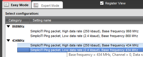

I'm having trouble to detect the sync word (0x1234) with CC110L. My application is 434MHz of center freq. 20kHz of deviation, 162kHz of Rx filter BW, 2.4k baud rate, fixed packet lenght of 8 bytes, 200kHz of channel spacing and using channel 0. This last channel config is the SmartRf recommendation. I'm also using iocfg2 = 0x0e to know when the sync word is detected.
When i use any 16 bit sync word configuration it detects sync word randomly but when i read RX FIFO it is only garbage bytes. In any 32 bit configuration it doesn't detect anything and with preamble/sync word disable it gets my signal but with bit dessynched, which makes sense.

  • I've tried 0xbcbc, 0xbbbb and the default 0xd391 too.
    I'm using SmartRf studio to generate register values, the board isn't direct connected to it because is the final board not a development one.

  • I was using this one to generate my custom settings.
    Also tried with yours settings but didn't detect sync even thought it shows that carrier is above threshold.
    Doing some test i noticed that when it comes from power down and i configure GDO2 to output PLL lock with 0x0A value it goes high immediately and a few us after it goes low and even when i strobe SCAL it keeps low forever. What is expected to see when i use 0x0A in the GDoxCFG and strobe SCAL? Could it all be a problem with the oscillator?
