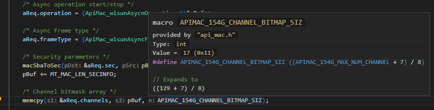

I was having a few problems sending the MAC_WS_ASYNC_REQ message from my Host application to the CoProcessor and after inspecting the issue I noticed there's an error in the TI-15.4-STACK-CoP Interface Guide.
It states that the length of the message should be 0x26 bytes-long (since the Channels field is supposed to be 25 bytes-long).
When in reality the Channels field only occupies 17 bytes, thus the message itself is 0x1E bytes-long (instead of 0x26).
Since this document has never been updated, it might affect all versions of the Simplelink SDK containing it.
