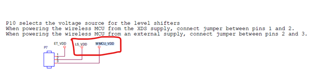

May I know is it possible to power CC1352P with a battery and use USB communication at the same time.
HARI
Hi RGW,
I connected 3.3V to the board from an external power supply and installed the Jumpers as specified.
What I observed is that even after turing off the 3.3V power supply,the board is detected in the Smart RF studio.
May I know is that expected.?
HARI

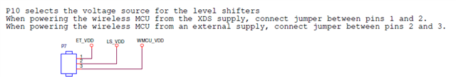

Looks like you still have jumpers inserted on the power signals between the XDS section and the radio section which could explain why the board still works when turning off the 3.3 V power supply.
Remove these two jumpers:
Good to hear it is working.
