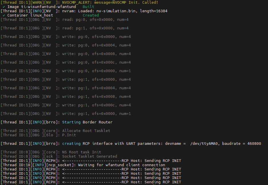

I have LP-CC1352P-1 using the oroginal rcp_lmac example and the RCP doe snot get anything from the br. please refer to my screenshot where the system is keep sending and waiting for a response. I was told the default baud for that is already 460800.
I have no nodes programmed by now, not sure if that matters, as I was expecting to get something from rcp_lmac first. Is there any command/charecters that I can send via other uart just to test it.

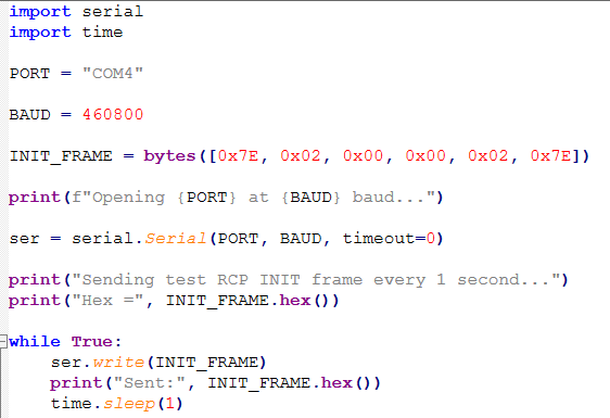

I even wrote this to send a dummy response but still nothing.

    • RCP firmware is running correctly and transmits continuous binary frames at 460800 (verified by connecting CC1352 TX directly to a PC).
    • Pi UART2 loopback test at 460800 passes, confirming correct host TX/RX timing.
    • When Pi TX is connected to CC1352 RX (DIO12), the RCP changes behaviour (TX activity gated), but never completes Spinel handshake (no IND_RESET). Even the CC sends something at each request captured by PC
    • Border Router transitions from timeout to hang while attempting to decode RX data, indicating RX activity is present but frames are invalid.
    • This behaviour persists even with correct baud on both sides and no NV restore.
    This strongly suggests an RX integrity or pin-mapping issue specific to LP-CC1352P7-1 at 460800, rather than baud or protocol mismatch.
