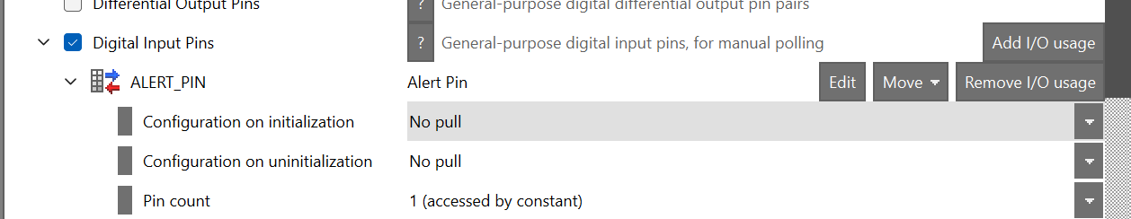

I am using CC1310, and while reading the state of a GPIO pin I am encountering an issue.
When I configure IO0 and IO1, I always read a value of 0 using the API, even though I verified on the hardware side that the pin level is HIGH.
However, when I change the configuration to IO1, I can correctly read 1 when the pin is HIGH. But when I connect the pin to 0V (ground), the API returns a value of 3 instead of 0.
I am using the gpioGetInputValue(1, alertState) API to read the pin state.
Below is my example code:
U16 alertState;
gpioGetInputValue(1, alertState);
output.tempRead = alertState;
if (alertState == 1) {
    output.alert = 1;
    fwGenAlertInterrupt();
if (alertState != 1) {
    output.alert = 0;
fwScheduleTask(1);
My GPIO configuration is shown below.
  • Hi tech_team,
    What package size are you using? Are you using a LAUCHXL-CC1310, this comes in a 7x7 package and there is no GPIO0. Or are you using a custom board with a different package size?
    However I think the issue is that you are using  gpioGetInputValue(1; alertState) instead use the GPIO name defined by Sensor Controller, I think the index might had been incorrect.
    Go to I/O Mapping and assign Alert Pin to DIO1, and use
    gpioGetInputValue(AUXIO_I_ALERT_PIN; alertState);
