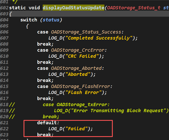

I tried to send an OAD request on Linux, But the sensor will display CRC Failed

    Transfer ab.dim to Linux and issue it to the sensor using the 'u' commandimage.png
    The above figure shows the output after the last instruction of sensor load

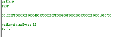

    Now, back to the TOAD, I can see in the collector_log.txt that the delta image "ab.dim" is being detected as a regular image and not as a TOAD image, I believe this might be the reason for the CRC error. I'll get back to you later.

    I apologize for the delay, it took quite some work to find the issue, I appreciate your patience.
    Please replace the following 3 files:
    1. On the Linux side, replace example/collector/collector.c
    There were two issues here: first, there was a wrong offset in fseek(oadFile, IMG_HDR_ADDR, SEEK_SET); it was hardcoded to 0x00 which didn't work for TIRTOS_IN_ROM. Second, sizeof("TURBOOAD") returns 9 due to the null terminator. This caused the image to be recognized as a regular OAD and not a Turbo OAD.
    After replacing the file, rebuild your Linux host:
    ./build_all.sh clean
    ./build_all.sh
    4265.collector.c
    2. After fixing the first part, the image was still rejected because a fail in the boundary check, so I replaced a "less than" with a "less than or equal".
    After this change, rebuild your project. Since the CCS project is copying (instead of linking) from the source code, you have to replace it locally inside your project and in the SDK for future use.
    simplelink_cc13x0_sdk_4_20_02_07/source/ti/ti154stack/apps/sensor_oad_offchip/CC13X0_LAUNCHXL/oad_client.c
    CCS project/Application/oad_client.c
    Now rebuild your project and generate a new .hex

        case OADStorage_CrcError:
            LCD_WRITE_STRING("OAD CRC failed", 3);
            break;
        case OADStorage_Aborted:
            LCD_WRITE_STRING("OAD aborted", 3);
            break;
        default:
            LCD_WRITE_STRING("OAD failed", 3);
            break;

                    // Stop OAD timer until there is more room in the cache to continue the transfer
                    oadClockSet(0);
                    isOADPaused = true;
                Util_setEvent(oadClientParams.pEvent, SENSOR_TOAD_DECODE_EVT);
    #endif
            else
                status = OADStorage_imgBlockWrite((blockNum * OAD_BLOCK_SIZE), blkData, OAD_BLOCK_SIZE);
                if(status != OADStorage_Status_Success)
    #ifndef CUI_DISABLE
                    displayOadStatusUpdate(status);
    #endif
                    /* OAD abort with no auto resume */
                    OADClient_abort(false);
                    return;
            //set poll rate back to default
            Ssf_setPollClock(defaultPollInterval);
            Jdllc_setPollRate(defaultPollInterval);

  • Hi Daniel,
    It is the display OadStatusUpdate () function in the oad_cient. c file
    I removed the three characters "OAD" in front of it for a unified prompt, as shown in Figure 2
    Daniel

  • Hi Daniel,
    I added a statement for you to print CRC, but the code cannot be executed at this point,
    Because my log shows that the verification failed after the first frame of data was sent, as shown in the figure with a value of 72
