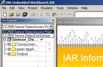

  • @Michael Unger:
    You probably need to switch the active build configuration (not just exclude the right files and rebuild the project). I had the same symptoms (LED's blinking but nothing happening), and while debugging i noticed that the end device was executing loops of code that it should do when it was an access point. Switching the active build configuration solved this for me.
    Hope this helps!
    Maarten
  • ""switch the active build configuration""
    How and What
  • @MartinPotts:
    Select the appropriate build configuration from the drop-down list.
