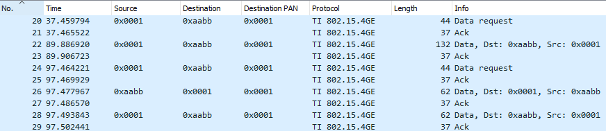

  • Hi Jim,
    I ran the test with two collectors as in the app note. With Orphan back-off time = 5s, and JDDLC_MAX_RECONNECTION_ATTEMPTS = 5, so it could take about ~30s to give up on trying until it tries to connect to another collector. The association is quite fast, about 1-2s.
    The back-off time and reconnection attempts are parameters you can tune yourself. You could shorten the back-off time and reduce the reconnection attempts. This is something you should try yourself.
    If you have installed SmartRF Packet Sniffer 2, you can observe the flow with the attached Wireshark capture. I removed the power on Collector 1 (0xaabb) on T = 40s, the device is fully connected to Collector 2 (0xbbaa) around T=82s
    https://e2e.ti.com/cfs-file/__key/communityserver-discussions-components-files/156/TI_2D00_15.4_5F00_dual_5F00_collector.pcapng
    Daniel
