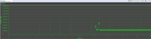

  • I am basing my work on that sample.
    Regarding the fact that you were unable to verify the issue:
    Did you perform a test where the device was left in standby mode for approximately 45 hours without pressing any buttons?
    The graph I posted earlier shows that there are moments when a 1mA current is drawn, even while the device remains in standby.
    Is the device not designed to maintain a standby state for such a duration?

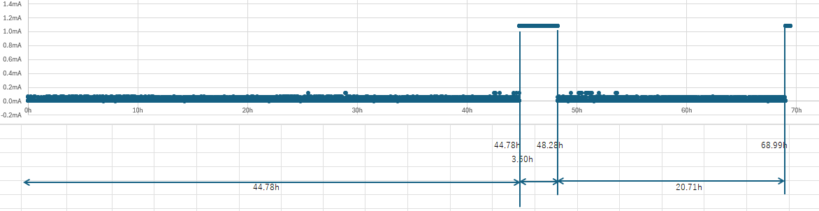

  • Debug logs are output to the UART upon reset, as well as when waking up from standby mode.
    An ammeter is permanently connected; since wireless communication occurs upon wake-up via pin interrupt—causing current to flow—I can distinguish the differences in operation.
    I naturally suspected the I/O pins as well, but found no issues there.
    As shown in the graph I provided earlier, the 1mA current draw persists for approximately 3.5 hours.
    No logs are output during this period, either.
    Having run out of alternative ideas on my end, I plan to use the source code you provided yesterday to test a simple implementation on the LaunchPad.
    I will let you know the results once I have them.
  • I am writing to report that the same phenomenon (1mA current draw) occurred on the evaluation board.
    I am attaching the waveforms and source code.
    Here are the details of the tests performed and their results:
    test1: Wake-up from standby using only the button → Remained in standby for 69 hours; no issues with current consumption.
    test2: test1 conditions + added Timer and RF transmission processing during active mode → Remained in standby for 69 hours; no issues with current consumption.
    test3: test2 conditions + added SPI and UART processing during active mode → Remained in standby for 69 hours; no issues with current consumption.
    test4: test3 conditions + added processing to wake up every 5 minutes using AON_RTC → Over the 69-hour period, the device cycled between 9 hours of standby and 3 hours of 0.8mA consumption (issue with current consumption observed).
    Based on these results, it appears that the use of AON_RTC triggered the 1mA current issue.

    I have figured out the logic behind the "9 hours = ultra-low current consumption" and "approx. 3 hours = 1mA current draw" behavior. When low-power operation is active, the function `void PowerCC26XX_standbyPolicy(void)`—found in the attached `PowerCC26X2_nortos.c` file—is presumably being called. It turns out that a situation was occurring where the condition on line 127— `if (time > Power_getTransitionLatency(PowerCC26XX_STANDBY, Power_TOTAL))` —was not met, preventing the transition to `Power_sleep(PowerCC26XX_STANDBY);` on line 139. In this case, the system remained in "Idle mode," which I believe accounts for the 1mA current draw. This state persisted for approximately 3 hours. During the 9-hour period, the condition was met, and `Power_sleep(PowerCC26XX_STANDBY);` was successfully called. So, I have a question: How should I modify the implementation to ensure the system always transitions to `Power_sleep(PowerCC26XX_STANDBY);`? Should I create a custom policy that operates independently of the scheduler, using `PowerCC26XX_standbyPolicy` as a reference?
  • The Power_getTransitionLatency function reports the minimal hardware transition latency for a specific sleep state.
    The power driver uses this function to determine if there is time to go to standby or not.
    If you do not enter standby, but IDLE instead, that simply means that there is something in your application that is scheduled in the near future, and that you have not time to enter Standby before this is to happen, and the device enters idle instead.
    The current consumption in IDLE is less that 0.6 mA, so that does not add up with the 1 mA you measure.
    We do not recommend anyone to start modifying the power driver, and have no recommendations as to how you can do this.
    Siri
  • Subsequent debugging revealed that on the evaluation board, `Power_getTransitionLatency` returns 0 at the moment the current drops to 0.8 mA. What does this signify? What is the reference basis for the duration measured by `Power_getTransitionLatency`? Since this is a noRTOS application, is it necessary for `Power_getTransitionLatency` to account for tasks scheduled to occur in the near future? Also, the system was entering the idle state via `PowerCC26X2_sysCtrlIdle(VIMS_ON_CPU_ON_MODE);`. The discrepancy regarding the 1 mA figure is due to the difference in circuit boards; the evaluation board draws 0.8 mA. The phenomenon should occur if the device is left running for nine hours after startup. Since I have provided the source code, could you please verify the issue and explain the underlying mechanism?
