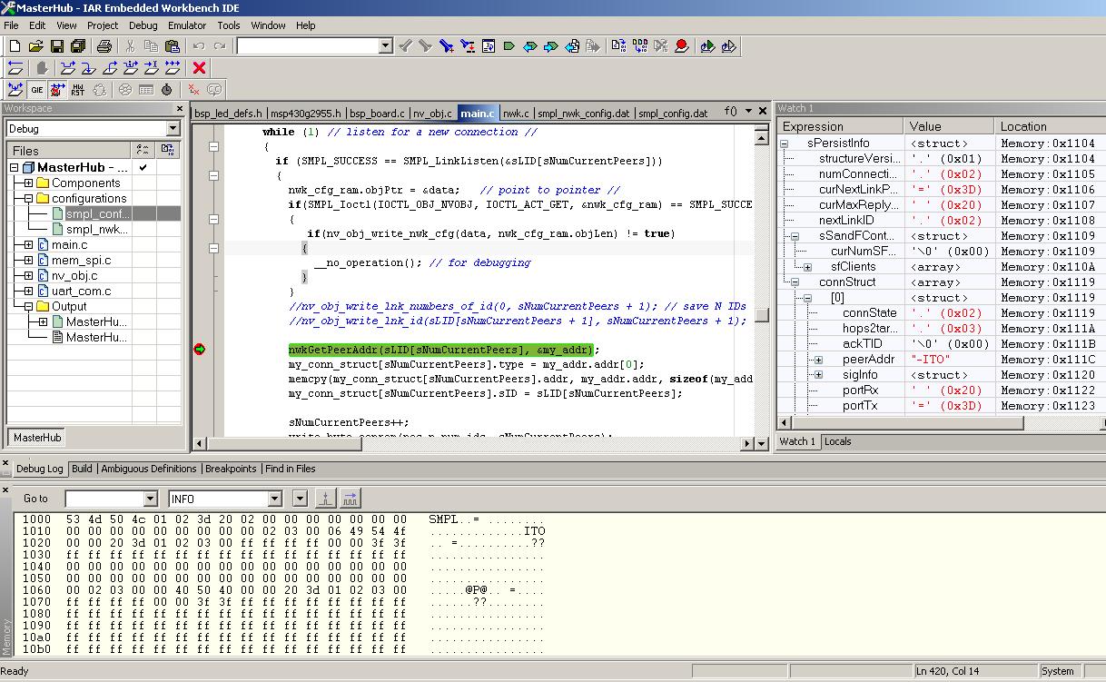

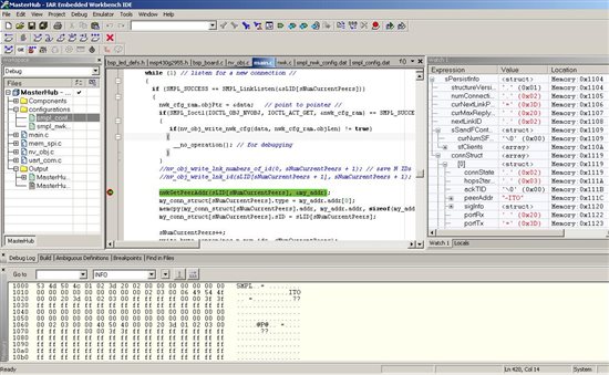

  • Ralph,
    i am not sure where the problem could be. Is it possible to get the screen capture of memory window showing the INFO memory in your application after calling  nv_obj_write_nwk_cfg() and also compare it with the memory windows showing the content of sPersistInfo variable in nwk.c?
  • Dear Leo,
    As you suggest, below is the data:
    Any sugestions?
    regards,
  • Ralph, taking a quick look at the memory dump, it seems that the content of the INFO memory acter calling nv_obj_write_nwk_cfg() is quite ok. The peer address is saved as "0x06 0x49 0x54 0x4F" in the info memory. The only thing is that if you use my example as is, it should be actually "0x4C 0x49 0x54 0x4F" ("LITO"). The first byte is different - i am not sure whether you change it on purpose or it is corrupted.
    So after calling nv_obj_write_nwk_cfg(), does the content of INFO memory stay the same after power cycle?
  • Dear Leo,
    The first byte was changed by me, the intention is that this first byte is as an identifier (ID) of the End Device.
    Also, in fact I can read (and also write) the correct configuration but only if I put the DNUM_CONNECTIONS variable at most at 3, if I put higher, for example 4 I can't write it correctly and I read zeros. Only problem, I need at least 7 connections. Is there any way to workaround this issue?
    Ralph
  • Hi Ralph,
    maybe it is because the INFO memory is not enough to store 7 connections. I believe i used only INFO B-D which has in total 3*64  = 192 bytes. You need to store the connection somewhere else then in the main code memory if this is not enough.
