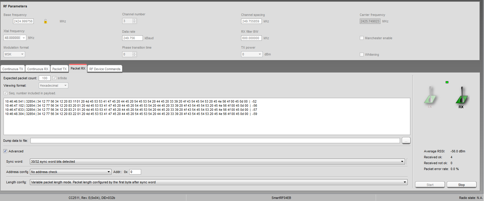

I have an USB CC2511 dongle and i connected it to a smartRF04EB board in order to
watch packet transmitted between Z430 RF2500T modules.
I use SmartRF Studio 7 application to see data.
I have one Access Point and one Peer.
My peer send a packet to AP and the AP send back an auto acknowledgement.
I can see the data packet transmitted to AP on SmartRF Studio but i can't see the ACK frame.
I'm sure that this ACK frame is transmitted because i can see it on another application ("Packet Sniffer").
More over the ACK frame is good because the peer toggle a LED when transmit successfull (ACK is received).
Here is a screenshot of SmartRF application (we can see only transmitted data frame but not ACK frame...):
Do you have any idea?

  • Actually there is no CRC filtering since i can see some packet with a bad CRC.
    More over in advanced tab on "Adress config", there is  "No address check" selected,
    so basically no filter are enabled i think...
    I can't figure out why the ACK is not showed.

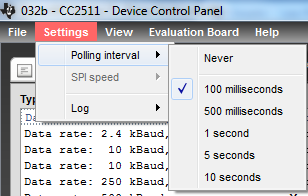

  • There is a parameter in SmartRf which is in "Settings->Polling Interval"
    The lowest value is 100ms:
    The ACK frame is sent about 2ms after the data packet is send so what
    happening between two poll if two packet are received (data+ack)?
    [EDIT] I have the same issue with the repeated frame (by a Range Extender) and the ACK answer. The two are not showed.
    Normally they arrive 4ms after the data packet is send (I see it in "Packet Sniffer")
    I think it's the polling setting in SmartRF which is not enought small.
    If a frame arrive in less than 100ms then frame is lost (buffer overflow).

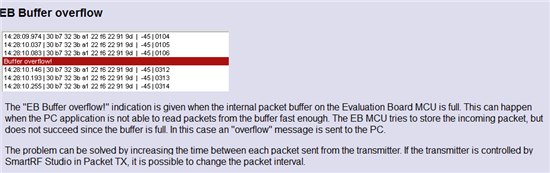

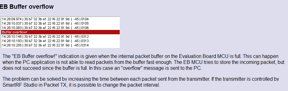

    It's not a normal thing i think because in the help we can read that buffer overflow can occurs and are displayed:
    But i never got a buffer overflow on the screen...

  • The polling interval is for the state indication (IDLE/TX/RX) of the connected device, displayed in the low side of the Device Control Panel. It should not have an impact on the the performance in Packet RX test function.
    The EB Buffer overflow indication is, I think, only supported for transceivers. Packet reception is handled differently for transceivers, however I see that this is maybe not clearly stated in the help document.

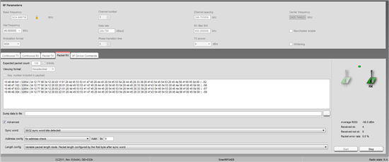

    I know that SmartRF doesn't program the chip because i just correct a problem with the USB dongle which was
    temporally dead (USB was not anymore in the device under Windows and the LED was always OFF)
    "PacketSniffer" was not able to dectect the key. So i reprogram it with smartRF Flasher and sniffer hex file.
    Now it works again.
    In fact it's not only the ACK frame which is not catch, but also a full frame (send by a Range Extender for example) which is not captured too.
    The two are send quickly after the data packet is send (4ms).
    Max
    The problem is related to the packet handler implemented for SmartRF04EB. The USB MCU on this board is different from the USB MCU used on SmartRF05EB, CC Debugger and TrxEB. The implementation for SmartRF04EB does not have any buffer handling. The packet handling is a lot slower since it is controlled from the PC side. Each time a packet is received, the packet must be read and processed on the PC side before the device is ready to receive the next packet.
    In this case the receiver will not be ready when the ACK answer is sent over the air. That also means that the "buffer overflow" feature is not supported by SmartRF04EB.
    Just to verify what TIABO already mentioned about the polling interval: This is only used for polling of the radio state. The polling is turned off when starting in packet mode.
    This can be seen when the indication on the right bottom corner changes to "N.A" (Not Applicable).
