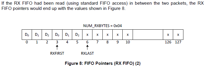

Please let me ask about CC112x RX FIFO access using standard FIFO access. As far as I read Users Guide(Page 17, Figure 8), each length byte will be omitted.

    My original question is come from Direct FIFO Access. I have seen following description on Users Guide, and it looks the length byte are omitted. Therefore I understood the length information is stored to another memory. I know the question is unrealistic but that is why I'm wondering how does it work when the maximum number of packet.
    Which scenarios this execution will be issued? Or is there any misunderstanding of mine?

    There is no problem even if the FIFO pointers gets close to 127 (end of FIFO). As long as NUM_RXBYTES is less than the FIFO size, there is "room" in the FIFO. The FIFO pointers simply wrap around to zero again. To better understand how the FIFO pointers work I suggest that you use SmartRF Studio and the "RF Device Command" window and monitor there how the FIFO pointers changes (remember to press the refresh button before reading the registers). An alternative is to write your own code and monitor the pointers for the scenarios you have questions about.
