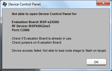

    Thank you very much for your response. I downloaded the code you suggested and saw that it was built for the IAR Workbench so I opened it using that program but when I tried to compile there were errors and I couldn't get it to run correctly. I then looked at SmartRF (again from your previous response) and tried to configure the devices but that also failed. First, SmartRF found the devices but did not recognize the transceiver, then when I tried double clicking on the device to configure it, I get this error:
    The RX and TX Jumpers are rotated 90 degrees so that they're running parallel with the Air Module. The Air Module is lined up on the Launchpad such that the two space ships are facing the same way. I think that's all that needs to be done. I also tried replacing the RX/TX Jumpers with the cross jumpers that came with the Air Module and the same problem appeared. The ATC BoosterStack Lite GUI can't seem to find them either.

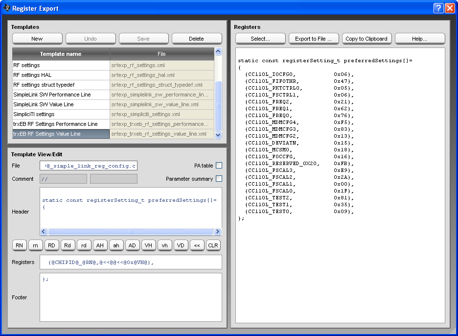

    I'm sorry if I was unclear in the previous post, but you can't program or control the Launchpad with SmartRF Studio. What I tried to tell you is that you can use SmartRF Studio to find your register settings (e.g. change data rate, modulation etc) and then export the register settings into the code (cc11xL_easy_link_msp_exp_430g2_reg_config.h ) using the register export function.

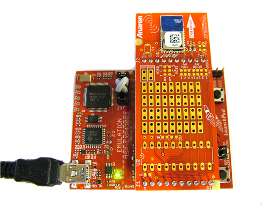

    Depending on which revision you have of the launchpad you need to use the cross jumpers for the RXD and TXD pins. I have used version 1.4 of the launchpad and this need the cross jumpers (see picture below). I know that for newer versions of the board this is fixed so you don't need the cross jumpers, but I do not know from which version.
