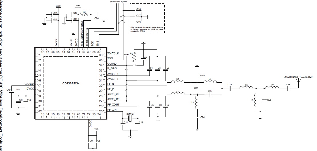

    I have inserted the schematics file . I made it in Eagle. For making this I strictly follow the the application circuit given in CC430F6137.pdf.

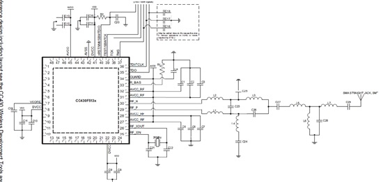

    Here I am attaching PDF version of my schematics and Image of circuit given in CC430F6137.pdf, that I followed for making this schematics.
    Some pin is shown open in PDF but it is connected to either ports of CC430F6137 or GND, depending on requirement.

    But still facing problem with RF part. My code for transmitting data from RF works with eZ430-Chrono for 433Mhz. But It is not working with the PCB I made. I am getting the Interrupt for end of package (with TX ) correctly but I am not getting data transmitted.
    Can you please check my RF circuit part. It will be very helpful for me..
    Thanks & Regard
    Vivek
  • Vivik,
    Initially the most critical item to check when making you own board is the XTAL frequency. The frequency needs to be correct, that is with +/-20 parts per million or +/-500 hz at 26MHz. Depending on what test hardware you have available there are various methods of checking this.
    A RF spectrum analyzer is the easiest. The RF PLL will multiply the XTAL frequency up to say 915MHz and you can use a spectrum analyzer to check how much the carrier frequency is off. If you do not have a spectrum analyzer you can use some TI development kits and SmartRF studio and sweeps the band for RSSI and manually make a plot of where the center frequency is.
    I believe this is the root cause of what you are experiencing. If they are off enough the transmitter will be outside the receive bandwidth filter of the reciever and nothing will work.
    /TA

    But can you check the circuit I have attached before and confirm me that It will work for 433MHz. Because in the schematic of eZ430-Chronos, I found some different circuit for RF part.

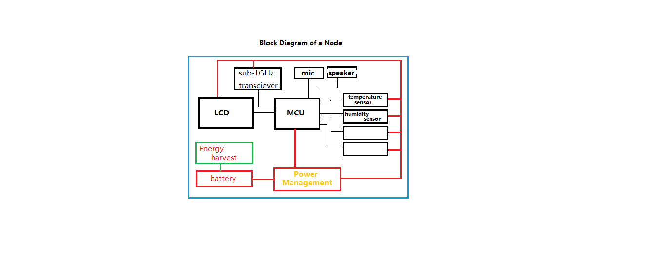

    Thank u very much for your response. Actually I want to design a low power patient monitoring node that would take data from patient and send wirelessly to base station such as PC. There is a block diagram below u may have a look and suggest me something that could helpful for me, honestly speaking I am new in electronic and don’t know much about circuits, u may suggest me some suitable appropriate sensors.
    Im using CC430F6137 microcontroller.
    And I want to use analog sensors
