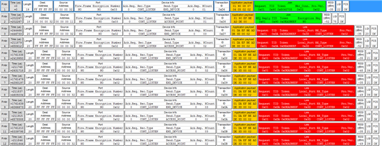

It means, that "SMPL_Init(sCB)" don't returns "SMPL_SUCCESS". I tryed to sniff transmitted message with other device and RF-studio with same radio settings as ED has:
14:51:19.719 | 65535 | ff ff 00 00 00 33 03 01 d8 01 90 08 07 06 05 02 02
14:51:21.686 | 65535 | ff ff 00 00 00 33 03 01 d9 01 90 08 07 06 05 02 02
14:51:23.647 | 65535 | ff ff 00 00 00 33 03 01 da 01 90 08 07 06 05 02 02
14:51:25.622 | 65535 | ff ff 00 00 00 33 03 01 db 01 90 08 07 06 05 02 02
14:51:27.580 | 65535 | ff ff 00 00 00 33 03 01 dc 01 90 08 07 06 05 02 02
14:51:29.549 | 65535 | ff ff 00 00 00 33 03 01 dd 01 90 08 07 06 05 02 02
14:51:31.516 | 65535 | ff ff 00 00 00 33 03 01 de 01 90 08 07 06 05 02 02
14:51:33.480 | 65535 | ff ff 00 00 00 33 03 01 df 01 90 08 07 06 05 02 02
14:51:35.451 | 65535 | ff ff 00 00 00 33 03 01 e0 01 90 08 07 06 05 02 02

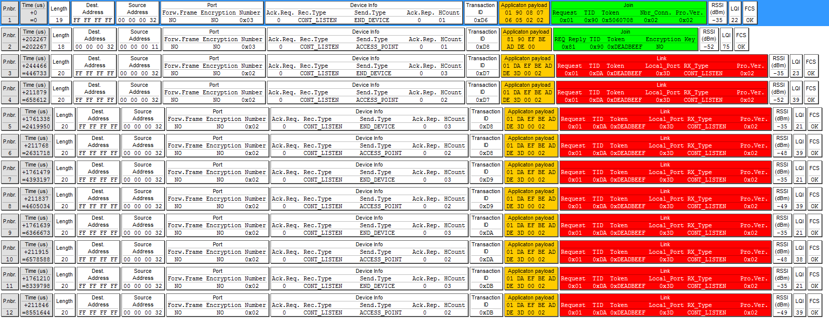

    Results of message windows from ED and AP:
    ED:
    SimpliciTI - Simple Access Point with UART
    End Device.
    Successful joined.
    Trying to link. . . . . . . . . . . . .
    AP:
    Access Point.
    Waiting for join.
    MrfiSyncPinRxIsr
    dispatchFrame
    nwk_processJoin
    handleJoinRequest
    smpl_send_join_reply
    nwk_sendFrame
    MrfiSyncPinRxIsr
    dispatchFrame
    MrfiSyncPinRxIsr
    dispatchFrame
    MrfiSyncPinRxIsr
    dispatchFrame
    MrfiSyncPinRxIsr
    dispatchFrame
    It seems, ED joins with AP only, but doesn't link. And again, AP doesn't go in any subroutine of main loop, except UART flag reporting.
    I hope, Leo, you can help me resolve this problem.
  • I've used sniffer on CC1111 dongle. There is the "LinkTo" request from ED and there is the answer from AP. These two requests go one by one infinitely. Also, it's  strange, that in AP answer "Source address" is set to 00 00 00 32 - actually this is ED adress. Where can a mistake be hidden?
