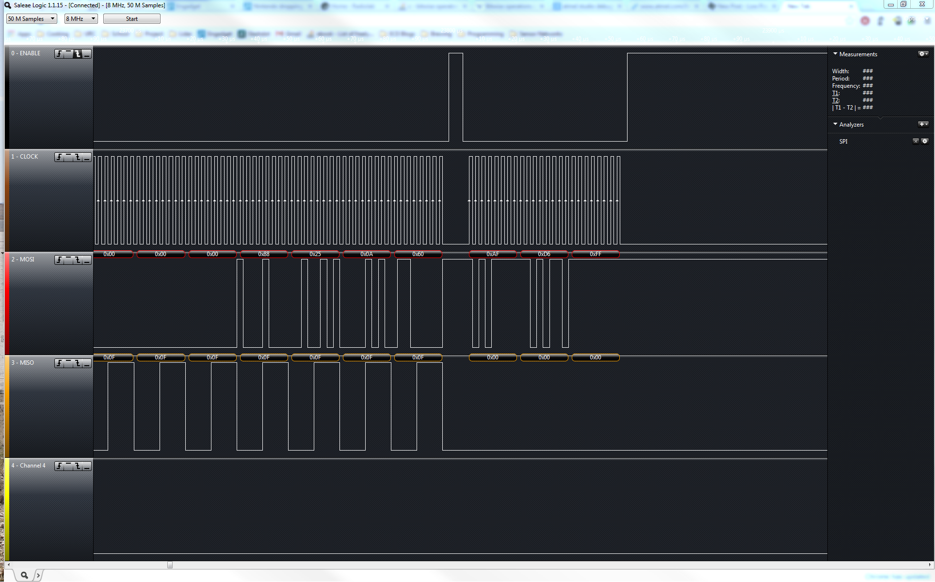

I'm currently bringing up the CC1200 EVM and I'm having an issue getting the data into the FIFO to TX.  I've validated that my cofiguration is being written as shown below and that I'm writing data to the correct address for the FIFO.  However, when I read the NUM_TX_BYTES register, I'm getting a response of 0.  I've attached two screen shots below of data I'm writing to the chip fifo, the first is the start of the fifo write, and the second is the tail end and the NUM_TX_BYTES query.  Any thoughts on what's going on?

  • Matthias,
    The first thing is to make sure that you can write and read to simple registers, like CC_IOCFG2, in your code write something to it that is not the same as the RESET value. Then read it back and confirm it work. If that does not work, then you need to make sure you have pulled the RESET line of the CC1200 high and that you are waiting until after the CC1200 tells you it is "ready".
    If this works, please post your code snippets that performs the FIFO writes.
    /TA
  • Thanks for your reply.  I'm currently able to validate the registers are being correctly written for the configuration and use a routine to check for MISO low before writing.  Here's the relevant code.  If there are any holes I need to fill in I'd be glad too.

  • Matthias,
    As far as I can see your "checkReady" routine breaks the communication. The only thing you need to do is to make sure the SO pins goes low. Like, so
    while(ioport_get_pin_level(CC_SPI_MISO_PIN));
    But in your code you are deselecting the chip right after you check for the SO pin to be low, therefore any communication following that does not get recognized.
    I recommend making you checkReady a lot simpler:
    void cc_checkReady(void)
     ioport_reset_pin_mode(CC_SPI_MISO_PIN);
     	ioport_enable_pin(CC_SPI_MISO_PIN);
     	ioport_set_pin_dir(CC_SPI_MISO_PIN, IOPORT_DIR_INPUT);
     	ioport_set_pin_mode(CC_SPI_MISO_PIN, CC_SPI_MISO_MODE);
     	ioport_disable_pin(CC_SPI_MISO_PIN);
    You have already selected the chip before you called the subroutine. Don't mess with the chip select pin more that absolutely needed.
    /TA
  • Oddly enough... the way Atmel writes their SPI library, "selecting" the line doesn't actually appear to drive the line low.  It maintains state until you actually cause an access and the ioport_get_pin_value function returns the last state of the pin it had as an IO pin... I don't think it actually updates the value when a peripheral mux is enabled.  This was the best implementation I could come up with for the Atmel ASF libraries. If you look at the logic captures, it appears that the CS line actually stays low if you leave it in that state until the peripheral takes over at the start of the SPI write (which would drive it low).  This whole thing was pretty maddening at first.
    As far as my original issue was concerned, I tore down my boards, plugged back into the TXRX TI board, did another run with my settings minus the IO config, and things worked.  So I put everything back together with my SAM4L in the loop and things seem to be working now.. I may have failed to do a hard reset on the CC1200 after I wrote some bad configs in my initial bring up that were being held.  Seems to be working fine as a replacement for the old CC1101 we were using.
    As an aside... are there any curves available for the expected gains for the CC1200 DSSS implementation?  Given the effect a very similar scheme seems to have on the link budget for the SX1272/3/6 by Semtech, I'm hoping to be able to pick up a good chunk link by enabling the mode.
