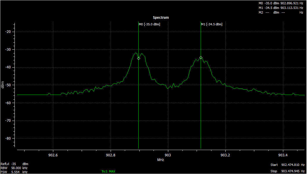

Hello
I am configuring CC1020 as RX and following are the default settings
// X-tal frequency: 14.745600 MHz    Internal
// X-tal accuracy: +/-  5 ppm
// RF frequency A: 927.678900 MHz    Active      Rx
// RF frequency B: 927.678900 MHz    Inactive    Tx
// Frequency separation: 216 kHz
// Data rate: 38.400 kBaud
// Data Format: Manchester        Accurate
// RF output power: +5 dBm
// Channel width: 500 kHz
// Modulation: FSK        Dithering enabled
// Lock: Continuous
// Carrier sense offset:   0 dBm    DCLK squelch disabled
// Operator Mode: Tx
Later on I am configuring the RX frequency to 902.9751 MHz.
My transmitter has the following spectrum
But when I configure CC1020 as transmitter the spectrum look a little different as below.
when I use CC1020 on the extra board I have as transmitter, then the RX using CC1020 work. But with the original transmitter, RX does not work. I can see that only random patterns are coming from the DIO pin when trying to receive with the original transmitter.
Although I set 216kHz for deviation, CC1020 produce around 256kHz of deviation is this fine?
How much is the allowable difference in centre frequency between TX and RX ?
  • Note that CC1020 uses Separation which is 2xdeviation. Try to use the same deviation on Rx and Tx side.
  • Hi TER
    Thank you for looking into my question.
    I have set the separation to be 216kHz and when I measure using spectrum analyzer as shown in my first post above, I am getting256kHz.
  • Could you post your register settings?

  • You write: "But with the original transmitter, RX does not work."
    Is the loop filter set correctly to allow for 38.4 kbps data rate?
    To measure the frequency deviation (or separation = 2 x deviation) use the frequency vs time option in the spectrum analyzer. Measuring the deviation in the frequency domain is not all that accurate
  • I have used the resistor and capacitor  values suggested by TI's SmartRF studio for loop filter.
    I have TI's USB spectrum analyzer. It does not have Frequency vs Time option.
  • I've never used this spectrum, have you tested the accuracy with a signal generator? I suspect that this is more a indicator than a analyzer.
  • Hi TER
    I only have a limited test setup and this USB analyzer is one of them. Yes, this is more of an indicator
