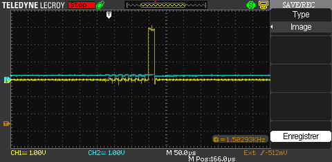

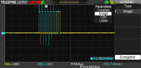

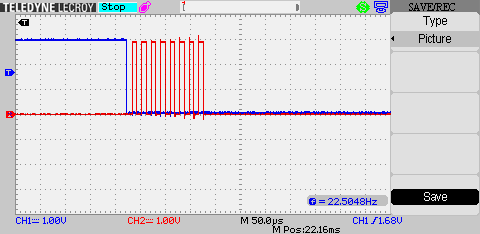

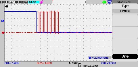

I have problems to communicate with CC1200 emk using SPI. Indeed, to communicate with I use a STM32F4-discovery board and only i have in output is 0xFF while I have 0 at the scope (0.3V to be accurate). Moreover at the scope I can clearly see the STM32's clock and MOSI pin with good sync and 3V for 1 and 0V for 0. I supply CC1200 emk with 3.3V.
After reading the CC1200's datasheet, I configured my STM32's SPI like this :
- SPI full duplex                         - CPHA and CPOL = 0
- 8bits data transfer                 - I use 256 of clk prescaler to be sure to be under 10MHz
- MSB 1st                                   - Master mode
I think the problem is that the CC1200 doesn't understand what I'm sending with my controller but i really don't know why. I checked some points :
- changed the CPHA
- disable pull-down resistor
- verify CC1200 works : The GPIO 0 is by default on Ext_Osc_En and with an extern interruption I can detect a rising edge when I power off and power on the CC1200. If you have better ideas to know if CC1200 works correctly I would like to hear them.
I can't use devKit for sub 1Ghz module kit because it's simply too expansive and I think to use SPI with CC1200 this device will not help me.
I'm beginner with SPI and CC1200 and I want to understand what are my mistakes. Thank you for your help, here is my code for the STM32F4 :

  • Hi Siri,
    Thanks for your reply. I have powered the CC1200EM using Vdd pin with 3.3V and GnD connected to the ground. I guess it's well powered because the GPIO 0 output is 3.3V to indicate that the EXT_OSC is ready, but I cannot be totally sure.
    The MCU has the same ground  that the CC1200 because I put a wire to connect MCU's ground pin to the CC1200's ground with a solderless breadboard.
    With 2 scopes I send you some plots to show my problem (They have not a 4 input scope) :
    In blue we have the Csn and the clock in red
    At the same time we have this :
    This plot shows the clk and mosi pins. We can see that i send a byte 0x01 with a good sync with the clock. The next picture is the same scope with miso and mosi. The clock is connected to the EXT trigger to be synchronized with the other scope :
    The Miso pin is low and doesn't react with the MCU.
    After theses tests I discover something strange, when I connect only the CC1200 and the MCU I can measure 1.5V at the Miso pin (voltmeter) , that explains why I have 0xFF at this pin. When I connect a scope probe to see what is going on, I can measure 0V (voltmeter) at the same pin and I have 0 at the computer screen with received values. Is this behavior tell you something? When I'm waiting the miso pin is low, it's ok in the 2nd case of this strange behavior.
    The line to wait PB14 (Miso pin) :
    while(GPIO_ReadInputDataBit(GPIOB, GPIO_Pin_14)== Bit_SET);
    I hope I give you all Information that you wanted to help me.
    Erwan.
    Hi
    From what I can see on your plots your SPI looks OK when it comes to phase and polarity, but I am not exactly sure I understand what/how you are testing. Are you writing to a CC1200 register and then not reading the correct value back or is it something wrong with the HW so that you do not have the correct level on your pins.
    Sending a 0x01 on the MOSI line means that you are doing a single write to register 0x01 in Register Space. The radio will expect a second byte before pulling CSn high with the value you want to write to register 0x01.
    The status byte returned on the MISO line when doing this is 0x0F.
