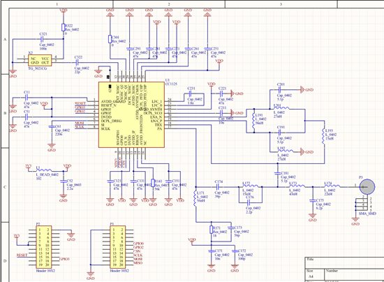

I design a board with CC1125EM 420/470MHz Reference Design(http://www.ti.com/tool/cc1125em-420-470-rd). But unfortunately, I failed.
The observations with my testing are shown as below:
1.It works with SmartRF Studio only when I run TX. I have observed with the spectrum and got the right wave. But if I run RX, it doesn't work. And if I try more, I will get the messege below.
The  parameters I used are from  settings.
2.I tried to run the Easylink code (http://www.ti.com/lit/zip/swrc253) with the parameters exported from SmartRF Studio, but it doesn't work. It stopped in the manualCalibration.
I nearly copy the TI CC1125EM 420/470MHz Reference Design totally. I use TCXO which is TG_5021CG(40MHz).
I don't know why it doesn't work. Should I adjust some components from the Reference Design?
Thanks!

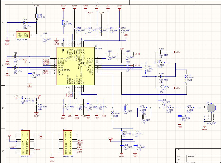

    There is my schematic:
  • Hm,
    - How do you assemble the boards? Do you solder the boards yourself?
    - On the failing boards, what is the voltage on the DCPL pins? RBIAS? It could be that you have managed to partially destroy the chip.
    The schematic looks good.
